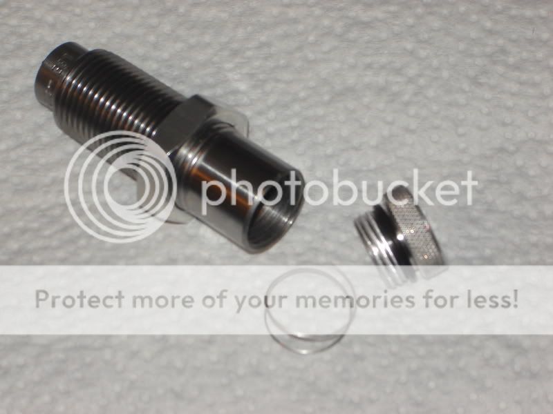

Heres for the lee collet die ,Mine went :mad:POP:mad: today on the 3rd 223 case ,and they were a brand new set of dies:confused:. I wasent pressing very hard and the aluminum threads let go , WTF why dont they make that top cap out of steel? makes no sence ................. guess I will be giving them a call tommorow .
Anyone know if you have to send the whole die back or ,just the top plug?
They will probably just send you the parts you need with nothing to do on your part but tell them what happened. When the linkage on my press broke, all I did was email a pic and they sent me the parts, no charge.

How hard were you pushing on that collet die? If you have to torque the #### out of it to size the neck then you may want to turn the mandrel down .001 with some fine sandpaper and a drill. I did it to mine and it takes alot less pressure now to get the neck to size down.
My .308 Lee collet die did the same thing and I've read others commenting on the same problem. I did polish down the mandrel but it was still not sizing properly. After it failed I took it apart and found that the mating surfaces of the collet section and the top section that squeezes it were galled from rubbing together and that seems to by why the die was binding. If I replace this die I think I will immediately take it apart and lube these surfaces then clean and re-lube them occasionally.
I did find that a drop of oil rubbed on the outside of the collet stopped the collet from sticking to the inside of the die.
I have to strip mine down every 20 or so sizings and re-lube to keep it from sticking. I have also had the problem where the sleve that presses against the shellholder started to roll under like the metal was not hardened?

I had it happen to one of mine (I have a dozen or so collet dies.) Though, it was my own fault - the cap had worked loose, so there were fewer threads holding it in, and I WAS using excessive pressure.
Fortunately, only the cap was damaged; it's easily replaceable. It's made of softer metal than the die body, probably by design for this very reason

I suspect that's the number one problem Lee support gets with this die. The procedure is different than with other dies, and too many people don't read the instructions. If you try and bottom out or cam over your press with one, you'll wreck the die. A friend of mine (who I won't mention) :p just did the same thing.
You screw the die down until it touches the press at the top of a stroke, and then back off the press and turn the die down two more full turns. At this point you won't be able to get a full stroke on your press without busting the die, but you don't want to. 25 pounds of down pressure, and that's it -you're done. It makes great, no runout necks, is easy on the brass, and doesn't require lube.
I've made literally thousands of rounds of sub-moa ammo with mine, and I'm still on my first die.
