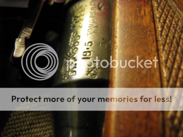

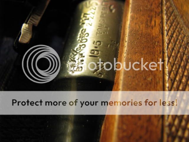

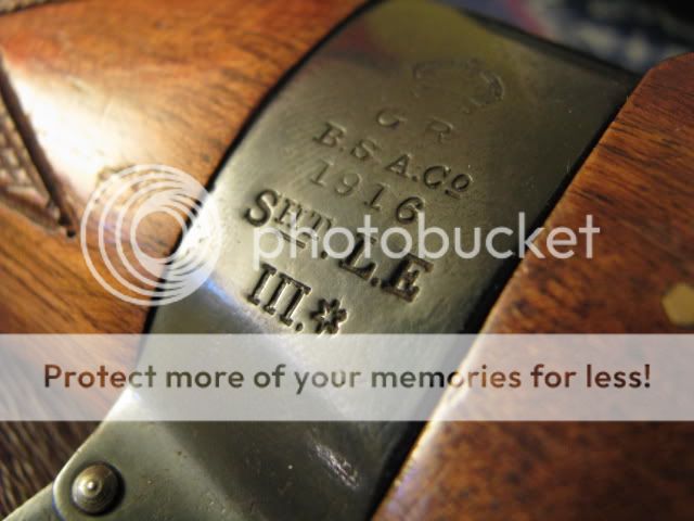

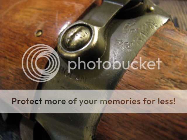

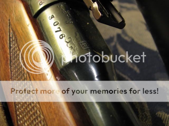

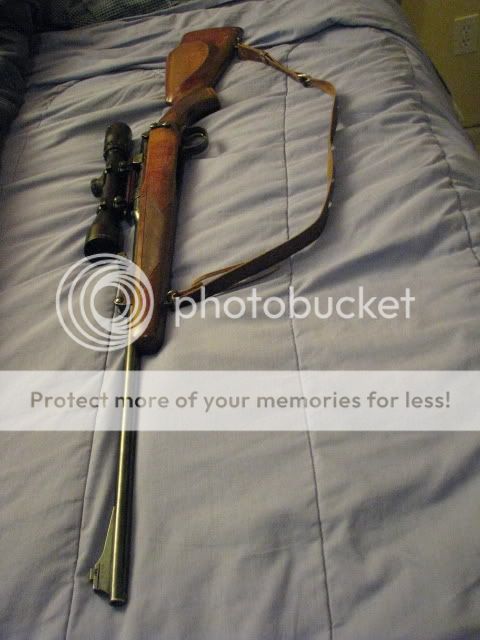

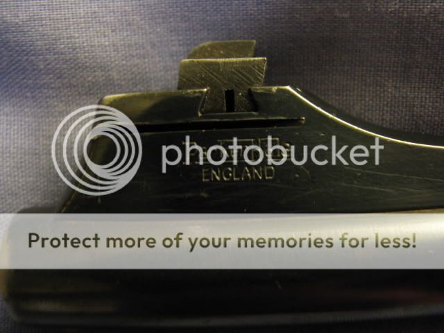

Hello everyone...I've always wondered what a couple of these marks meant, especially the "NOLAN" under the safety and what looks like crossed swords with 0, 6, B (I think) with them..these are different from the crossed flags which is one another part...also the R in the box is one I can't seem to find anywhere online. This seems to be a good place to find out. This one was sporterized by Parker Hale (I'll get one wearing the full dress when I can...)

The rifle is one of the higher grade PH sporters. I bet the "NOLAN' is a badly struck "ENGLAND".

Crossed swords with letters is a Birmingham proof mark, letters are a date code. Code started in 1950 with letter A, so letter O would designate 1965 as the year it was proofed for the civvy market.
Are you sure that it is an R and not a P? P in box mark would suggest that it has at sometime in its service life been through depot repair at the Poole facility. There are Enfield inspector marks on the right hand nocks form of the barrel which tells me it has had barrel work.
There is a date mark on left barrel nocks form '17 this designates the year of the Govt acceptance stamp. There will be a broad arrow mark close by. So barrel work was done in 1917.
Not unusual for a 1916 rifle with wartime use to be damaged on the battlefield and returned to a facility for a new barrel within the year.
Some markings have been obliterated by the civvy proof marks .BNP 303, 2.222, 18.5 tons per square o, The area has been buffed and some martial markings removed before the civvy markings were applied.
The rifle was in and out of the armourer's hands over a projected period. The markings on the left butt socket tell me that it has been govt inspected, in 1925, 1934 and 1959. Which indicates that this puppy had a long service life.
Wow thanks alot for all the info...so this rifle may have served in both world wars? It sure is amazing that some Saskatchewan deer hunting rifle can have so much history. Thanks for the links, very cool. I'm pretty sure it's an R and not a P, its one of the few marks that is actually stamped rather well..except it has what looks like it was lightly stamped above the R with the same stamp.
Yes, that rifle if it could talk, it would have an interesting story to tell. No doubt that it saw service in both world wars and after. Now doing duty putting meat on the table as a sporter. If it is looked after it will continue to do so for generations yet.
Nothing wrong with a sporter in my eyes if done properly. They were done for the practical purpose as a hunting tool and are part of our Canadian heritage.

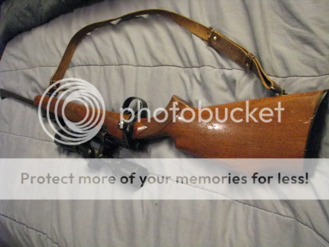

Parker Hale did nice commercial conversions. Show us some full length pics of the rifle.
You guys remind me of when my girlfriend would send me pictures years ago(now fiance)..."well that face picture was great, but how about a full body?" They are great rifles...can't wait to startin huntin beaver with it soon.
