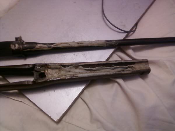

I baught this rifle a couple months ago and today I took it apart to give it a good clean. What I found was it looks like the last owner tried to bed the action and half the barrel with what looks to be Mono or some sort of plumbers putty maybe. Should I remove it or just leave it in there. The guy said it was accurate but I havent shot it a whole lot yet and only used the battle sights which im not to used to using, I tried the 150's and 180's and I could hit a 5 gallon bucket at 100 yards with the 150's and a 2L bottle with 180.

http://i1133.photobucket.com/albums/m583/leeaspell/2.jpg
Not a great pic off my phone
Yea I thaught it was body filler at first to. If I take it apart again, the stuff on the barrel will be on the stock, and stuff on the stock will be on different part of barrell, it isnt solid what so ever. So I guess tomorrow project is to clean it off.

"...just like Mono or playdough..." Hi. If it's that soft it's not doing anything anyway. Scrape it out, then clean the wood and put on a wood sealer.
