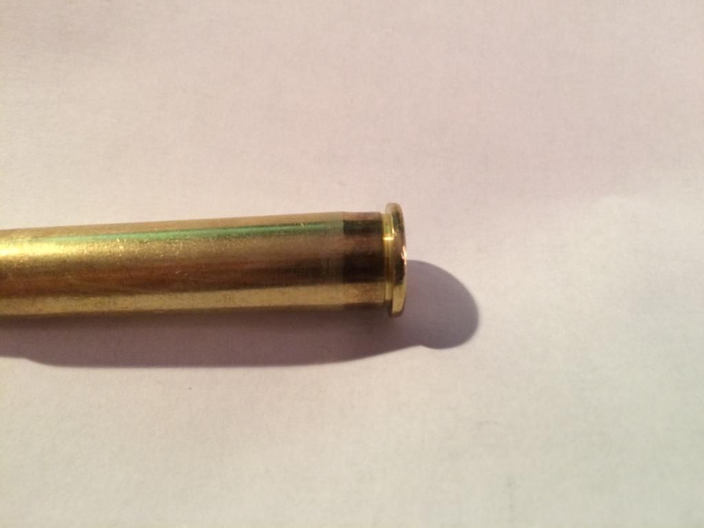

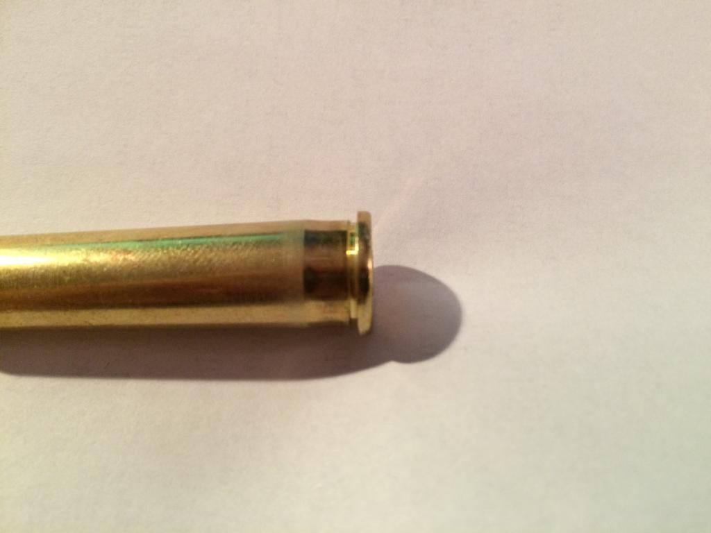

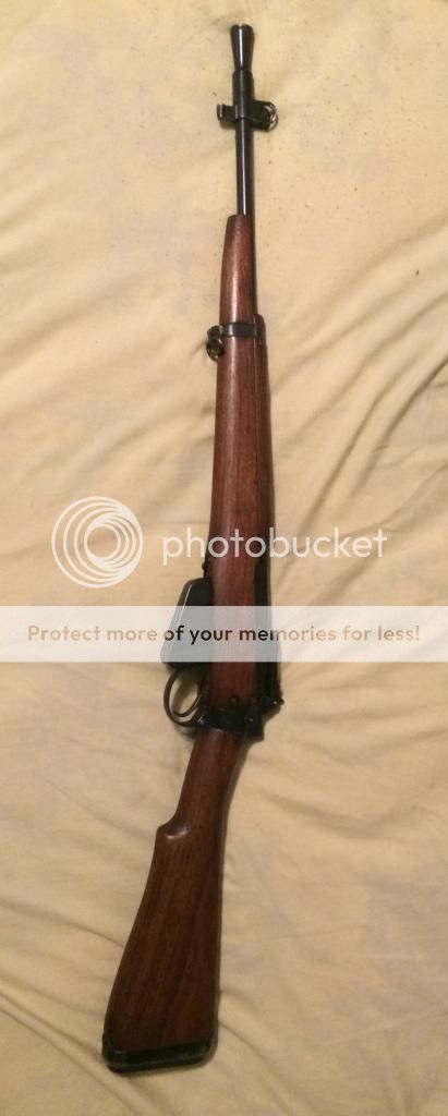

Got this in the mail yesterday from Elwood Epps and I must say they are handy little rifles. So I took it to the range today to see how it shoots and I found out there are issues with head space. So I'm wondering, assuming that the bolt heads are interchangeable with the No.4 could I then get a No.1 or No.2 bolt head to remedy the head space issue?

The No.4 and No. 5 bolts are interchangeable, not just the bolt head. The No.5's should have a hollowed out knob on the bolt handle but some like that were also used on some No.4s (because the bolts are interchangeable) and a No.5 in need of repair while in service could get a No.4 bolt as a replacement (because the bolts are interchangeable.)
How did you determine the headspace is bad? I doubt Epp's would sell an unsafe rifle, but a phone call will tell you if the headspace was checked by them. However, just changing the bolt head without headspace gauges will not necessarily fix anything.

I should have said by looking at the brass I came to the conclusion that the head space was off because compared to my No.4 that I was also shooting that day the brass had a more significant bulge to it where the walls of the case meet the head so I decided to err on the side of caution and not risk a case rupture or head separation , I also have a set a head space gauges on order.
So I ordered a No1. bolt head from marstar swapped it out and checked the headspace and everything checks out, I also did a chamber cast and everything is within what SAAMI lists for chamber dimensions.
