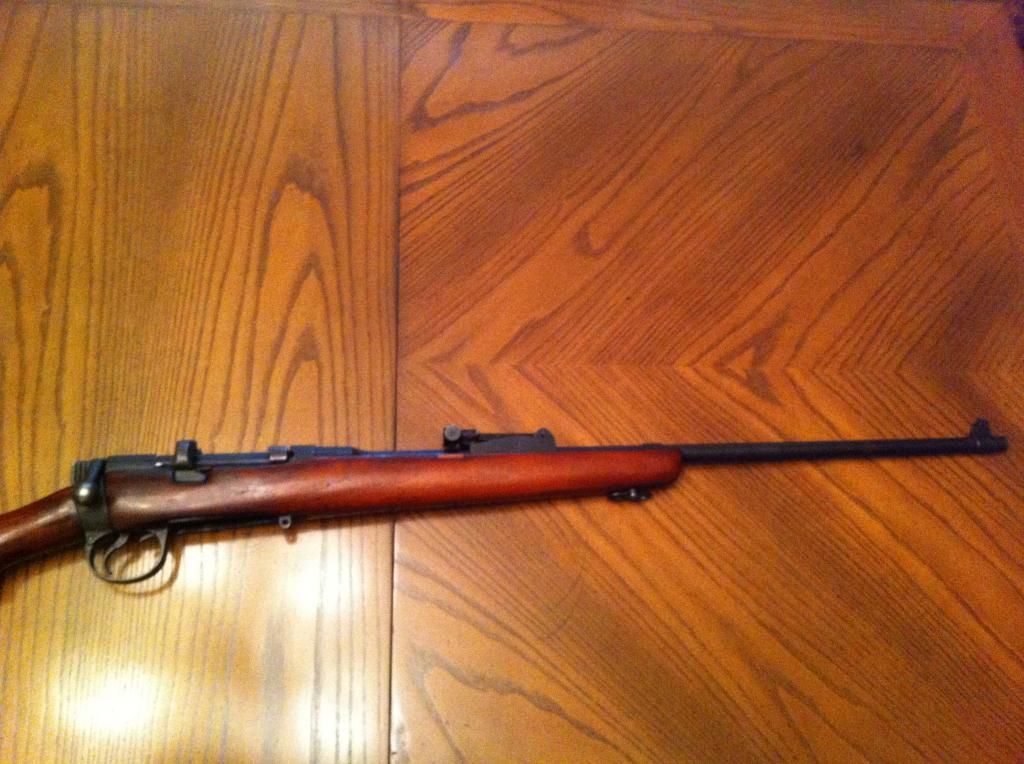

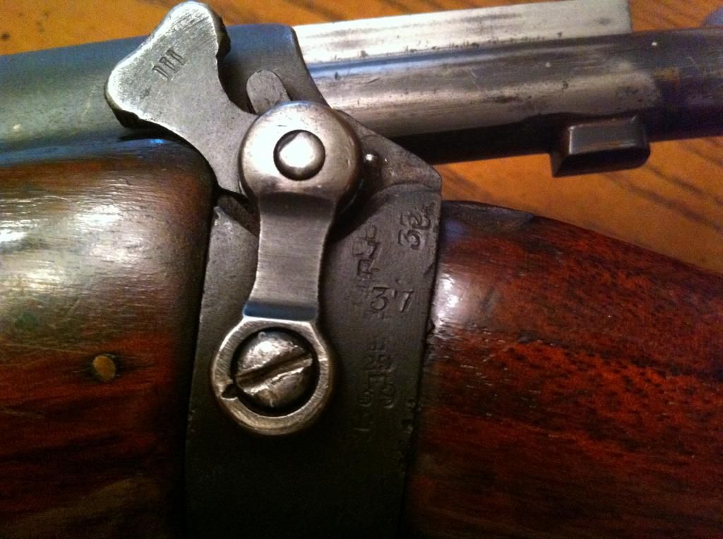

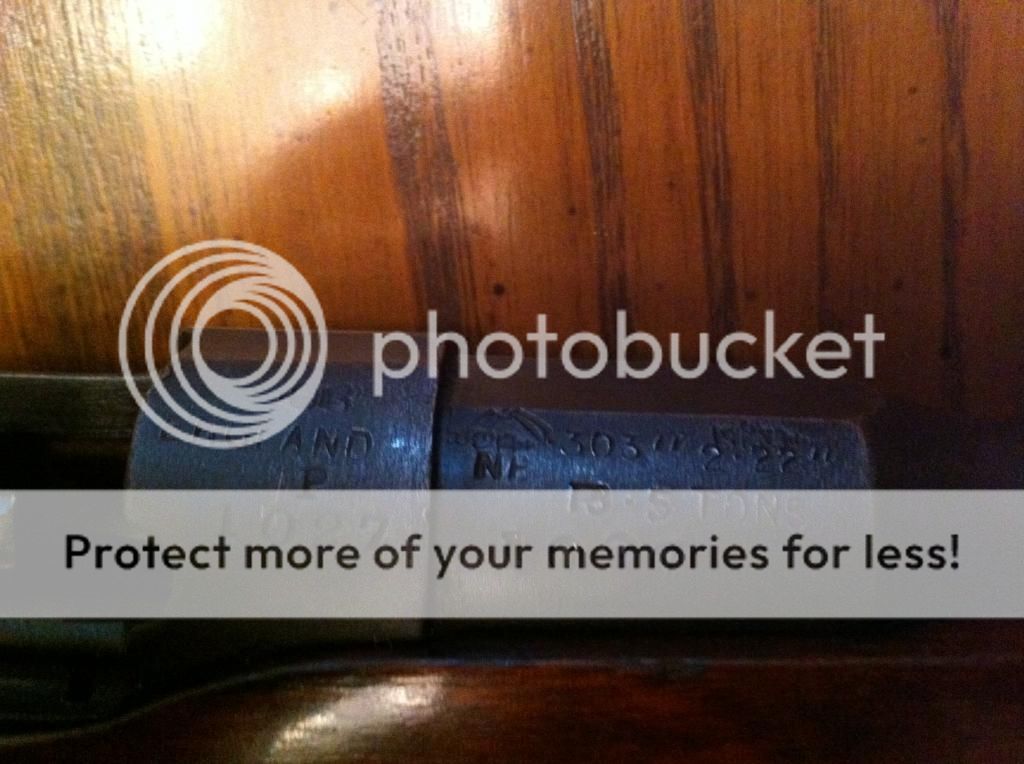

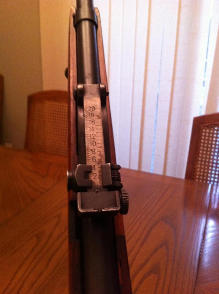

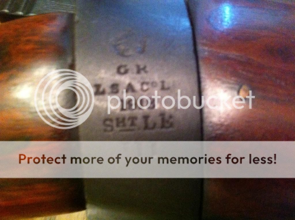

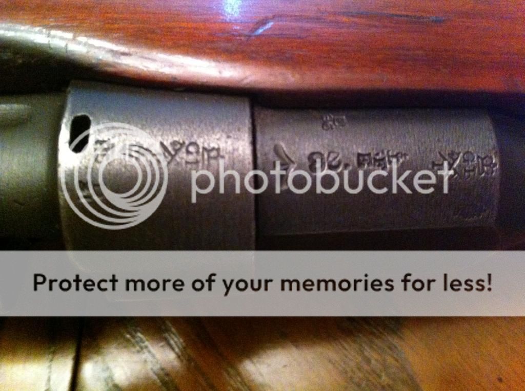

The gun is complete and in incredible shape. I shot it today. It's missing whatever it was that came in the compartment in the brass butt plate. I will try to get pictures up. There are at least 20 markings/stamps in various locations on the gun.
I'm pretty happy with it ;)
Thanks smellie!
