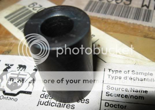

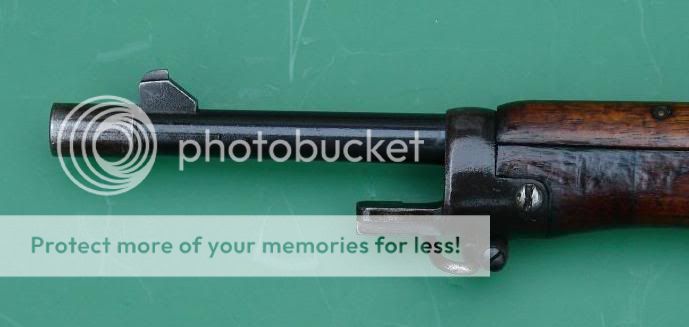

This is the bush I need to make up.
(not my picture, not my carbine)

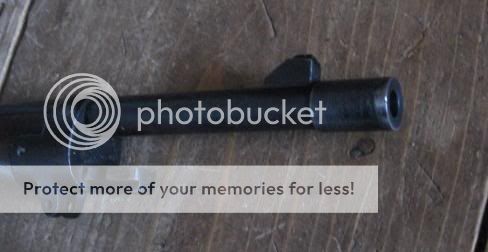

This is my muzzle sans bushing.
Here is a question; How was this bushing attached to the barrel?
I have sketched up a fabrication drawing of the bushing on the back of a cigarette packet and have determined that the wall thickness where it slips over the barrel is quite thin, about 40 thou. I am thinking that it was installed and held in position with solder or perhaps it was made undersize and heat shrunk into place.

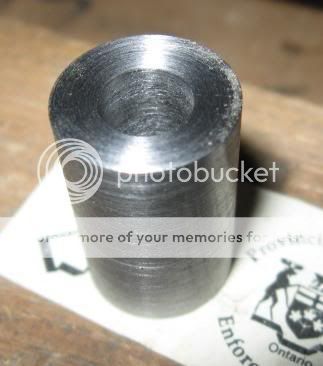

Tiriaq jumped in and came to the rescue, he used his turning skills to make up a bushing for me. Nice job! Measurements were dead nuts on to what I specified and the bushing fit like a charm.
The machined finish was very fine and even, so I used a piece of shagged out 400 waterproof emery paper and hand polished the sharp edges and gave it an overall buff to smooth things up in preparation for oil blackening.
Once polished, I fired up my camp stove and heated the bushing on an iron plate to a just right sizzling hot temp and then dropped the bushing into a soup can of motor oil. Washed it off with dish detergent, dried it, buffed it with fine steel wool and repeated two more times. Dense hard black finish. Too dense, so I polished the sharp edges with my shagged out emery again. I needed the bush to look like the rest of the finish on the carbine, so I added 100 years worth of handling wear ;)
The bush was a light interferance fit onto the barrel with a drop of loctite, a wooden block and hammer to made sure it was driven right home. A quick check with a dentist's pick down the bore tells me everything is snugged up and the bore of the bushing is just a few thou larger than the rifle bore, eyeballing it looks concentric. Perfect! Tiriaq even crowned the business end of the bushing, I'm pleased, it looks like it was installed at the factory 104 years ago!

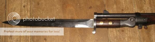

The whole point of putting this bushing on was to mount a P1888 bayonet. So I tried one. Click!

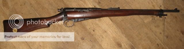

So the project is making good progress. Next thing to make up is the top handguard. I have a nice walnut SMLE unit with missing fingers that will lend itself nicely to being fitted.
