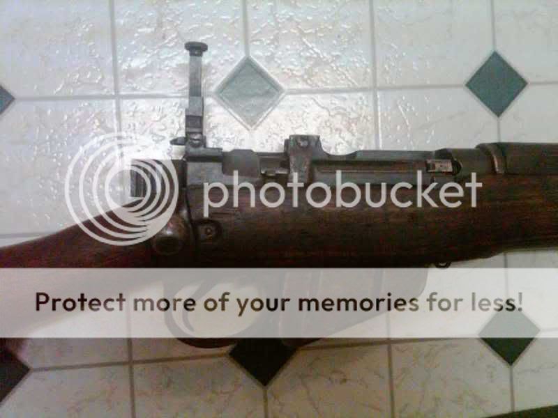

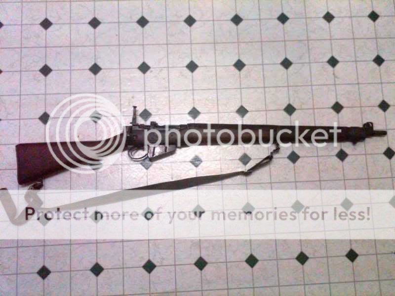

It is a No4Mk1 ... I'll get pics soon as my digi-cam just broke and my cell phone pics are crap. I want to find a NEW complete wood stock and handguards. I will eventually have "murdoc" from arma-coat strip, beadblast and reblue/park the rifle ... I am not replacing parts, I'm just tryna clean her up and put new wood on the ENTIRE rifle. Any help appreciated.

You have what looks like a pretty solid set of original wood there.
You can make it fit the rifle much better with a glass-bedding kit. They are worth about $35 but if you are careful you can bed threeor four rifles from one kit.
As to making the wood look a lot nicer, and preserving it into the bargain, LOT can be done with a wet cloth and an ordinary iron. I have a Japanese rifle here that I steamed more than 100 dents out of, then finished with boiled linseed oil. Starting with a piece of junk, I ended up with a darned nice rifle. Total cost was about $40, incluing 35 for the fireglass kit, and I had the pleasure (and, initially, frustration) of doing it myself.
