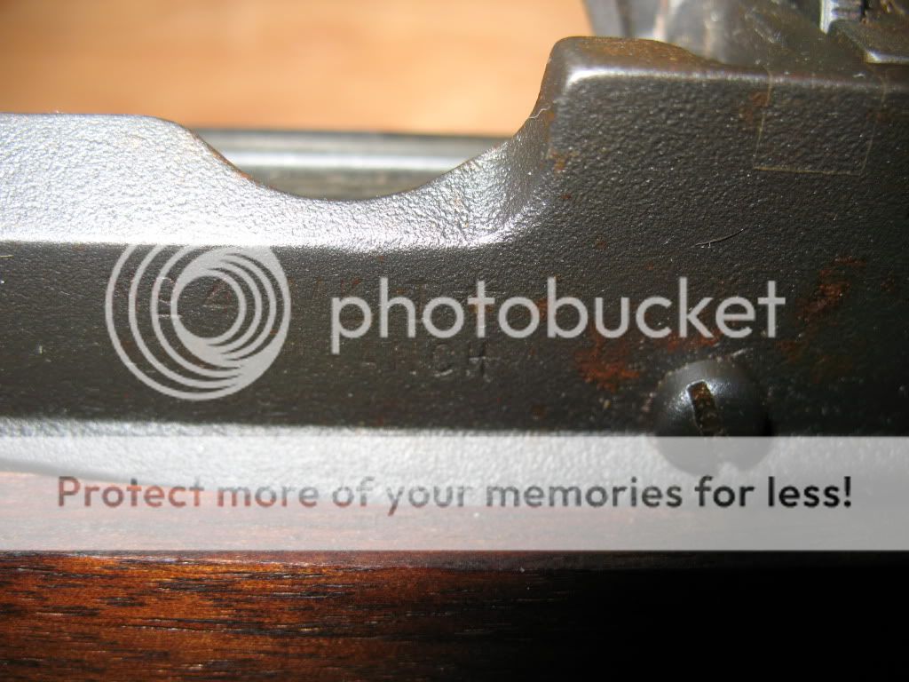

there seems to be a five point star on the barrell near the breach.

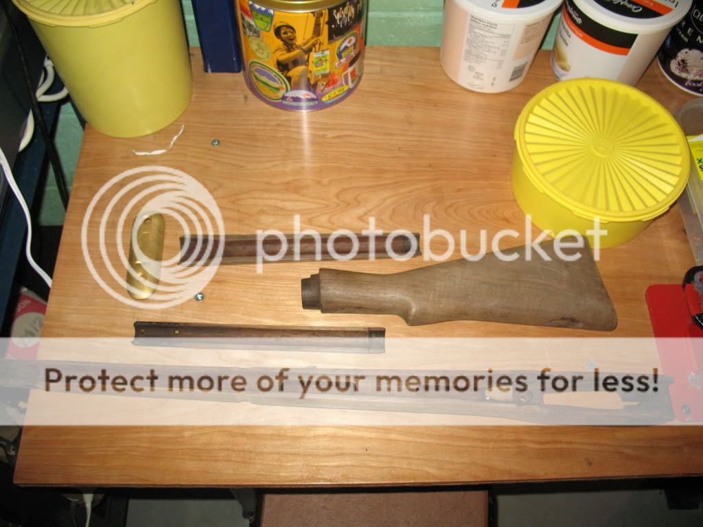

How do you know what type of wood it is? I work steel not wood. It looks redish inside where the rifle beds, not that it is stripped the "exterior" wood looks greyish, red, brown
What did you do to strip the wood?
If you simply sanded (please say you didn't), or used a furniture stripper like "Circa 1850", the wood will likelky still be oily deep inside. Many thin coats of pure BLO (I use the one made by "Recochem" found in the paint section at Canadian Tire, in 1 litre plastic bottles) should be good enough for your needs.
Lou
No didn't sand That would be just wrong, I started, after much reading with Oven Cleaner, then when it wasn't stripping the varnish I got some Circa 1850, then went back to the oven cleaner to get the grease out. So now it's totally bare wood. I'll try and get pictures up soon but I need to set up an account at one of the photo storage sites.
