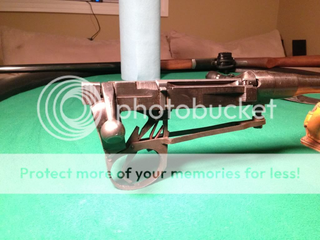

I recently aquired this out of boredom, but I am not knowledgeable about milsurps. I was hoping a CGNer could let me know what I have got. I can take more photos if necessary. Also anyone got the furniture for it for sale?

I think some of us would appreciate a nice picture of the LEFT side of this and a full-length shot.
"...badly hacked up..." That is being polite. Bubba was likely trying to mount a scope. Getting it to the point it's safe to shoot is going to be expensive. Check the headspace before you do anything else.
what steps will i need to take that will make it expensive? i will measure the head space which will not be an issue, after that what would be the next step?
i apologize for my naive purchase and lack of knowledge. i bought it from someone who advertised it as just needs stock and i was bored haha
Honestly, if it were me I'd just use it for parts and find another sporter Enfield to shoot. There's been a lot of metal removed from that receiver, it might be perfectly safe but is it worth it to find out?

Some of the guys are being too harsh on your barreled action LE.
Since it locks up on the front of the bolt, I can't see where anything done on it has weakened it, or made it dangerous to fire.
Headspace is not a big issue with the Lee Enfield, because if it has too much head space, you just have to get another little bolt head, one number bigger.
It locks at the rear!!! compare with the picture below & you can see clearly how much material has been removed leaving a large area of the right locking lug exposed.
IMO scrap the receiver!
It does indeed lock in the rear. There may be ample bearing on the receiver for the locking lug but with the bridge gone (I can't see how much is there) a lot og the strength there is gone. Hand load lightly.
I'm fairly new to reloading, I do have all the equipment. And lots of books with charts for loading .303. Probably best bet is to pick the lightest load tie a string to trigger and giver a test?

You could improve it a lot by rounding down the back corners of the action walls, as per the Long Branch half-stocked experimental sniper rifle recently shown in a thread here. I'm guessing it's a Maltby action with a Long Branch bolt in it.
More photos please.
No big deal. Some guys here are more anal than a proctologist. The enfield only bears on about 1/3 to 1/2 of the lug (which is why it is so fast). Throw some sporter wood on, check the headspace and enjoy. There is no bridge behind. The sight is the only bridge so no worries. That rifle is just as strong as any full-wood counterpart. Any person with any mechanical aptitude can see that.
