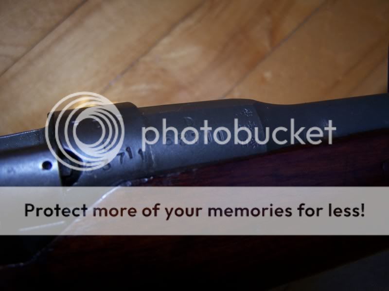

In photos 1 and 4 with the No1MkV is that the pointed end of a wood screw going through the forearm just under the chamber end of the barrel? If so your rifle likely went through an FTR at Ishapore. Next check your safety. The MkV used a MkIII style safety with a serrated bevel on the leading edge and is stamped with a V. Your also missing your stacking swivel. The MkV uses a narrower version than the earlier MkIII.
Also be a good idea to have a look at your shell cut off plate. If it has a “Viewing Hole” it’s likely a replacement.
Yes, there's a screw where you say, it's countersunk into the wood.
There's no hole in the shell cut-off plate, unless you mean the hole in the outer knob.
Stacking swivel...... not sure what you mean.

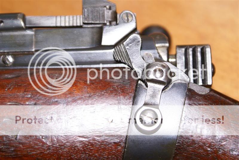

The safety is nothing like the JC's safety, it's un-uniform shape like a peanut with serrations on the top and back edges..... there's no "V" unless you mean the one on the gizmo that holds the safety switch to the gun (that looks more like an "up" arrow).
So what's the significance of these little changes at Ishapore? Seems like a waste of time.

Sorry it has taken me so long to get back to you with this. I needed to update a few photos for you.
Though the screw may not have been added during an FTR at Ishapore most rifles seen with this screw received it well in service in India.

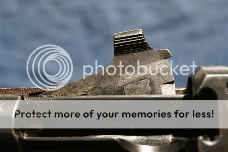

From what you’ve said you have the correct shell cutoff. When looking down into the action it should look like this one.
Cutoff plate without “Viewing Hole”

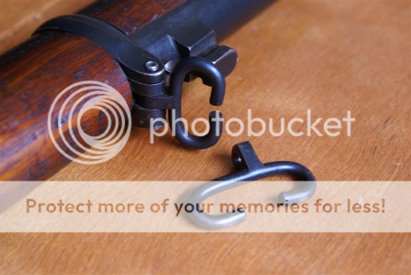

In the years between WWI and WWII a new style of “Stacking Swivel” was introduced and fitted to the MkV. They aren’t often see as so few service rifles were made between the wars and by the time production was restarted the use of a stacking swivel was ended. It’s not uncommon to see this part missing as most rifles still in inventory had it removed during any service work.
Stacking swivel with the older incorrect style shown lose
The proper safety for the MkV has a beveled and serrated front edge and is marked with a “V“ for Mk.V. If the part broke or became unserviceable often a regular No.1MkIII safety would be substituted as original replacement parts weren’t often available because of the rifles limited production and trials status.
Mk.V (No.1Mk.V) Safety.

You're absolutely right about the swivel and safety... my safety is the same shape but without face-serrations. The shell cut-off is as shown.
