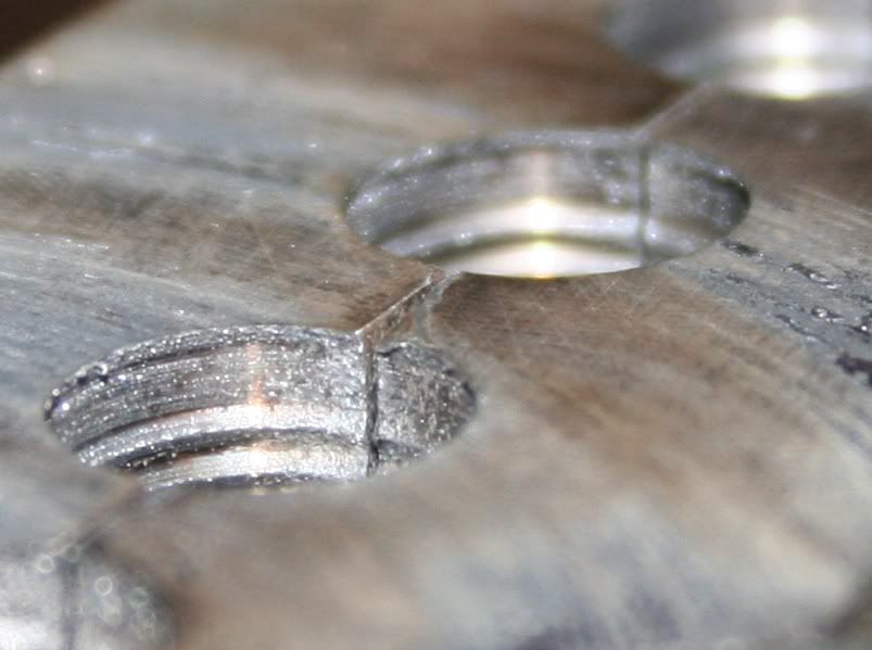

I dropped my mold. Dented one of the corners of the cavity and outside mold corner.
Base of bullet now might come out a little off and here's the lead I'm dealing with. Blah, I think i butchered this mold and it's my fault. Note the unintentional scrape marks. I'm going to order another one. At least I can keep the other stuff for parts. I'm going to smoke my 9mm mold blacker than night when I get around to using it.
Also, looking at my own pic, it probably explains why one of the cavities doesn't drop too well unless really up to temp b/c it looks like I didn't smoke it enough. The others drop fine when up to temp.

Smoking may help but it may not solve all your problems.
Smoking the mold will create a fine coating making the release easier from the mold but i find the lee molds need a bit of TLC when working with them.
Check all the edges and corners and carefully sand off any burs with a high grit sand paper, something like 400 and then a 600 grit.
I find that many lee molds have slight burs on them which will make the bullet “stick” in the mold.
See which particular cavity “sticks” and when the mold is nice and cold inspect the details of the cavity with a magnifying glass carefully.
