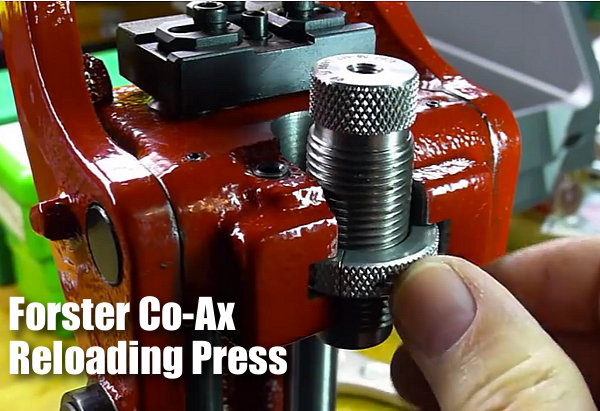

Go with the “O” — O-Rings May Reduce Run-Out When Sizing
http://bulletin.accurateshooter.com/2020/06/go-with-the-o-o-rings-may-reduce-run-out-when-sizing/
Simple test, start your sizing die into your press and stop before the lock ring contacts the press. Now wiggle the die and watch the movement of the die and you will understand how the die can be locked down off center in the press threads. Also, note the Forster Co Ax press allows the die to float for a reason.
Adding the rubber o-ring turns your press into a Co Ax press with its floating dies, which allows them to self center when the case enters the die.
Also note that the Forster dies have a high-mounted floating expander that does not pull the case necks off center. The case neck is held and centered in the neck of the die when the expander enters the case neck. So floating dies and expanders produce very concentric cases along with Forster seating dies.
