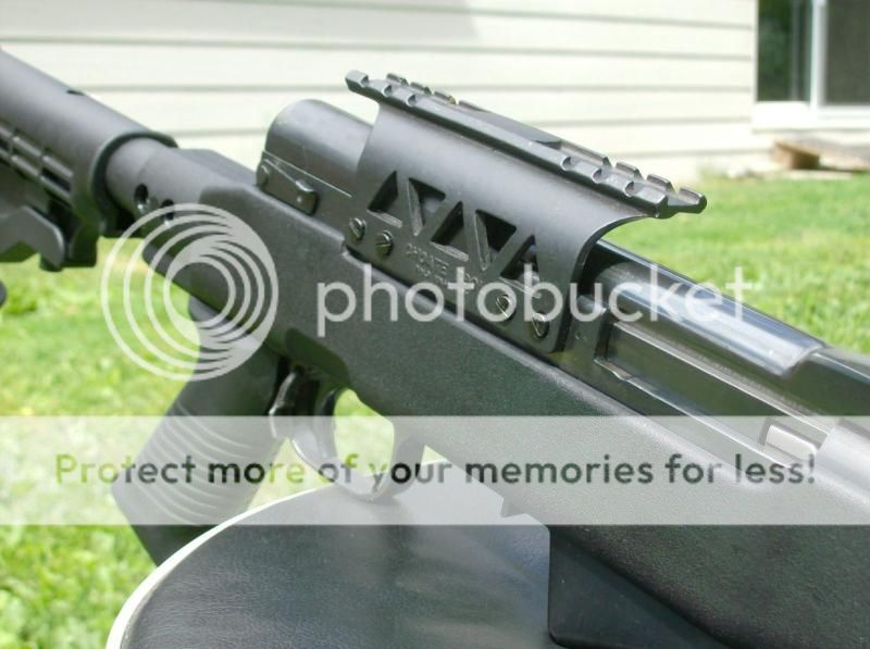

Second, I worked on the scope mount. Easy enough to level the mount with the receiver, a few hours in the shop drilling and tapping; step 1 completed.

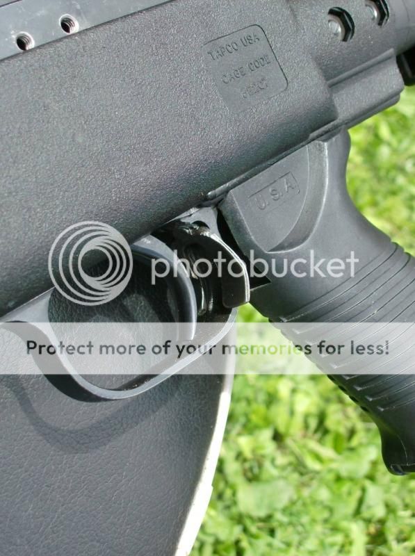

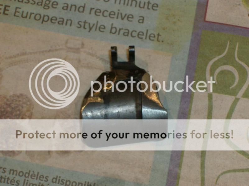

Second, I needed to modify the safety lever, because with one hand on the pistol grip and the other hand not worth much, the safety would have to be operated with the index. For this delicate welding, I didn't trust my beginner's skills, so I went to my local welder who has seen everything and done everything. He welded a curved section of steel, then I spent a couple of hours carefully grinding the part into shape; testing it on, removing it, a bit more grinding, repeat cycle many times...
Step 2 completed, let's move to step 3: the bolt carrier.
