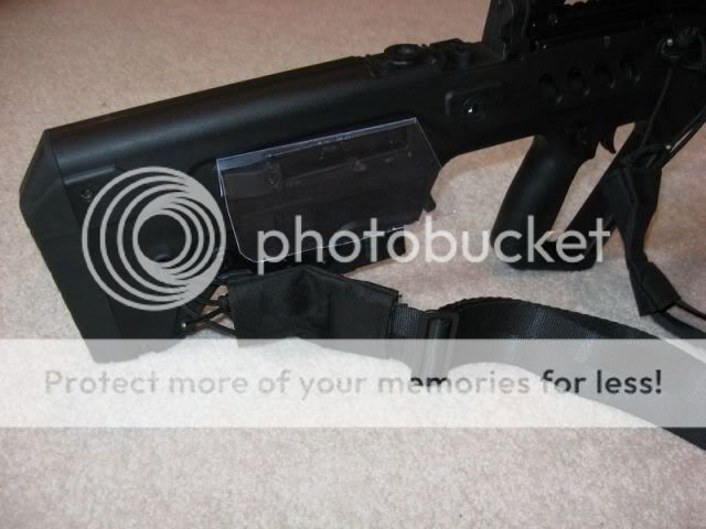

Not being too hopeful about seeing a left handed bolt for the Tavor I looked into making it less painful to shoot with right hand ejection. After a few failed attempts, promising starts, frozen fingers (I hate winter) and some minor facial injuries from hot brass I think I've got it!
And it's simple to boot. The basic premise is to keep the brass from smacking into the face while not impeding ejection, and that is all this does...nothing more, nothing less. It's just a piece of that indestructible packaging plastic with a tab and notch to hold it in place behind the deflector, and now the spent case smoothly slides across it to the side instead of snagging and burning across lips and/or chins.
In my case my chin just rests on the deflector which slopes down at about 20 degrees, and hasn't caused any problems in 50 rounds. It will direct toasty warm brass right down the neckline of anything not zipped up fully, though this is actually an advantage on a cold day like today. :)
The deflector itself is currently 2.5x5", and once it warms up I'll trim it down to see what the minimum required size is. Some method of cutting and bending this plastic nicely would be good also, as this is about as crude and ugly as it gets. :redface:
More to come as things (hopefully) progress...

With regards to bending the plastic, you need to heat it above its glass transition temperature. From some quick googling it seems common polymers used for that type of packaging are PVC (Tg = 81 0C) and PET (Tg = 69 0C). What you can try is immersing it in a pot of boiling water, bending it to a new shape, then while holding that shape dunk it in a pot of room temperature water. Maybe heating it with a heatgun on low setting might work too, but be careful, heatguns are powerful.
Tried a whole bunch of different materials and mounting methods, and finally ended up with about the simplest possible solution I could imagine. It's a piece of pre-bent indestructible packaging plastic held onto the rifle with a little screw. The plastic is flexible enough that I'm not worried about putting too much stress on the screw, and the molded corner is resilient enough to return to the correct position when the deflector is bent.
It'll never hold up to anything more than range or light field use, but if it allows me to actually fearlessly fire the rifle instead of bandaging my chin then that's more than good enough. :)
