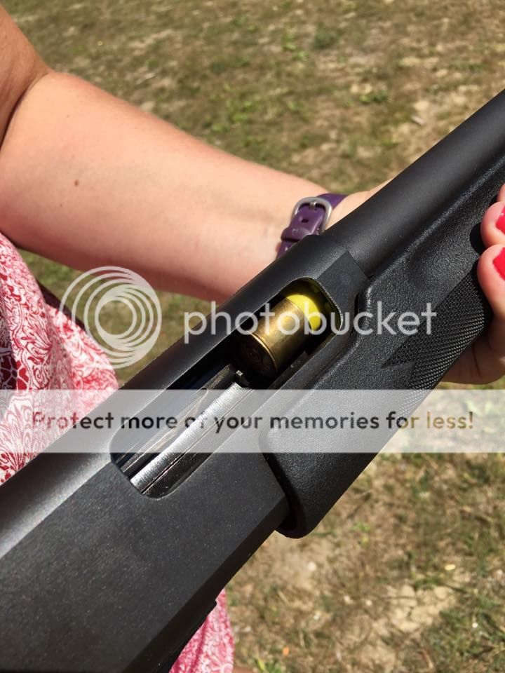

I recently purchased my wife a Canada Ammo Dominion Arms Grizzly in 20 ga. We are VERY happy with the firearm & finally got out to the range yesterday with it.
She ran some Winchester Super Speed 2&3/4" with 7.5 birdshot through the shotgun, NO PROBLEM.
She then tried to run some Winchester Super X Sabot Slugs. They fed, fired AND THEN JAMMED by only partially extracting the spent casing & feeding a live round from the mag. We repeated this 5 times & the result was the same each time. At this point I was like, uh oh...
But, switching to Winchester Super X Rifled Slugs, the firearm ran NO PROBLEM!
And back to Winchester Super Speed birdshot, again NO PROBLEM!
So, what is the lesson? Although I already knew it, I experienced a FIRST hand lesson on making sure you test your firearm with the ammunition you intend to use! I could NOT imagine the horror of being backcountry camping & needing that firearm in an emergency, only to have it jam & render the firearm useless when you need it most! (And yes, I know the Sabot slugs are meant for a rifled barrel, we were just function checking the firearm & fully intend to use the RIFLED slugs which work great in this shotgun.)

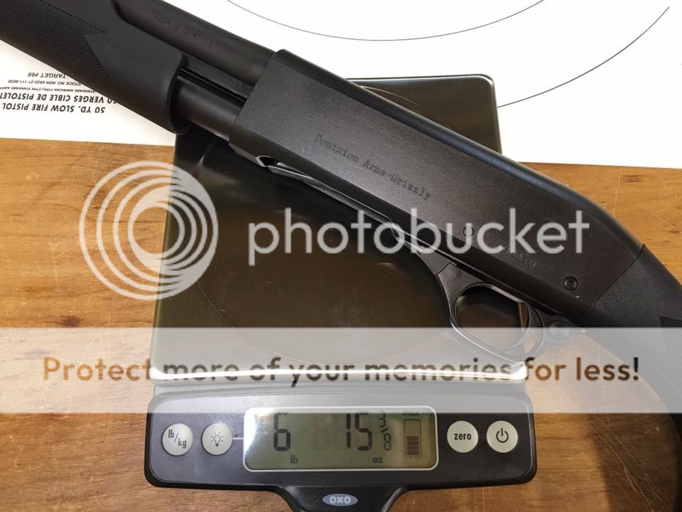

How's the weight on the CanAm 20 gauge ?
The 12 gauge is really heavy. Had a reminder of this just the other day. My CanAm 12 ga. has a lot of mods so it's much lighter. A friend picked up a new one recently. Wow, was it heavy !
My wife in now very interested in a compact 20 ga. At the moment we are hot on the Corwin offering but I like the fact that the CanAm is an 870 copy and will be much easy for modding or parts.
Jay,
I think you will be AS SURPRISED as I was when I weighed our two Dominion Arms Grizzly shotguns! After getting over the shock, chuckle, I realized that THAT is why her 20 ga kicks so mildly! So... I'm okay with it!
My wife's 20 ga Dominion Arms Grizzly is 6lbs 15 & 3/8's oz
My 12 ga Dominion Arms Grizzly is 6lbs 15 & 7/8's oz
Thanks for taking the time to weigh and post pictures Jay !! Very generous.
Oh I know the stock is REALLY heavy on these guns. So is the forend !! On my 12 ga. I replaced them with the Hogue 12" LOP. If I used it for hunting I'd go with the full length stock however.
The original stock & forend are in a pile of old parts. Every once in a while looking for something I pick up that stock set and am reminded of how heavy they really are.
Indeed, plus side is it helps absorb recoil.
Surprising the 12 & 20 are so close in weight. You'd figure with the more compact receiver, barrel etc. there would be a bigger gap.
