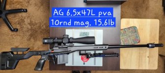

Here's my current rig, needs a new barrel now.
26" Proof 6.5 Creed chambered by Insite with Insite Heathen (now has MDT hunt brake)
Defiance Elite with TT Special 2-stage
MDT CRBN and modded triple-pull Ckyepod (lightweight Ckyepod head/gen 2 triple pull legs, now has gen 3 triple-pull)
Vortex Razor LHT 4.5-22 in Vortex rings with offset Vortex Venom rds and Impact 4000
a hair under 16lbs
