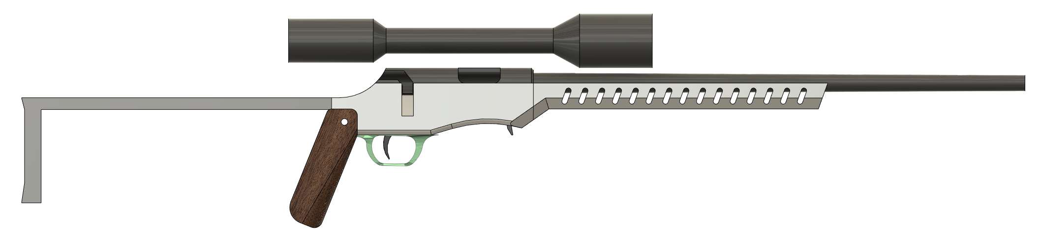

And this is where Im at after 1hr in fusion tonight. Chassis will be made out of solid Alu, Walnut grips and a 3D printed buttpad and either a tube or rod based "buffer tube".
It's very much NOT my normal style, but I think I have to embrace that "modern" look if Im to make a metal chassis in 2023. Feel free to drop any design suggestions (pics preferred) on how to make it look or feel nicer, such as the buttstock, grip shape, slot shape and position, etc etc. If there's anyone who owns a EM332 and would like one of these, it would be easier for me to mill a second one at the same time. I will probably make one out of pine again first to ensure all fitment and clearances work first. Of course, the barrel is free floated.
The idea is to put a Diamondback tactical or something obscenely large and expensive on this too. 16x min zoom.

might want a larger 'flat' in the mag area for silhouette and free-hand shooters
adjustable pistol grip position would be nice too
