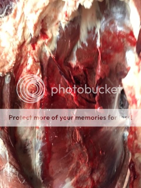

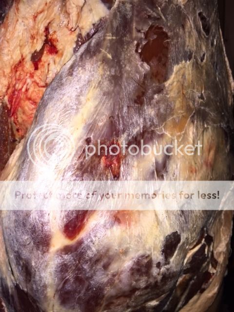

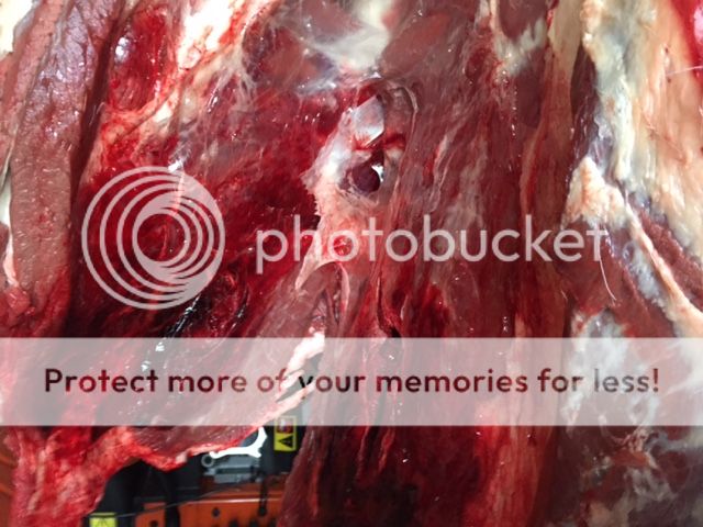

So I found some pics on the....uh, I mean I went out to my shop and took some pictures... :)
Near shoulder -
Far shoulder - right in center of picture at the top of the hair in the photo -
Between near shoulder and ribs
Between far shoulder and ribs - hole is centered, a little up from middle of picture
