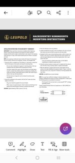

I have a set of Leupold ringmounts for a Sako 85, package does not state torque for the base or ring screws.
Any idea what the torque specs are?
upon closer look, that's not the ring I have. The ones I have have single screws on the rings, the ones in your pic are double..
My package doesn't say backcountry.. it says "ringmouts Ruger/Sako" and nothing else
Then it's 28 in/lbs for the ring top screws and 45 in/lbs for the keeper clamps to the dovetail.

I'd run 30in lbs on the bigger screw clamping it to the dovetail and 15in lbs on the ring cap screws

Leupold got back to me
45 inch-pounds for the clamp screw to the Receiver, and 25-28 inch-pounds max for the Ringtop screws.
