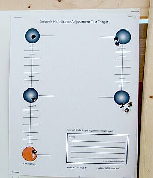

If you're worried about the adjustments on the scope, you can always shoot "the box."
Start with a single shot, on a very precise point of aim. Benchrest targets are great for this, especially a benchrest "square" stapled to a larger piece of paper.
Go a certain amount of clicks up. Same original point of aim. Say 16 clicks (4" nominal). Shoot a shot. 16 clicks (4") right. Shoot a shot with the same point of aim as all other groups. 16 clicks (4") down. Shoot a final shot.
Adjust 16 clicks left, and shoot the original spot again - starting round two. Continue through 3 or more rounds of shot-adjust-shot-adjust... etc.
Take your targets down, and find the exact centre of each 3-shot group. Draw straight lines connecting them. If it doesn't look like a perfect square, then you or your scope have an issue. Naturally a few degrees out of square isn't a huge issue... but if there are serious misalignments between where the groups ARE and where they SHOULD be...
Here's a box shot with a Schmidt and Bender scope, as described above.
-M
-M
There are no "clicks" on a scope with friction type adjustments, unfortunately, and the box test wouldn't mean a great deal on a scope with friction type adjustments. It's the nature of the beast.
I didn't realize the VX-I were friction adjust... that makes a lot of sense now.
Yeah, doing a box with friction-type makes about as much sense as voting for Obama. My bad for not knowing the VX-I was friction and not clickity-clack like my Mark 4 LR/T.
