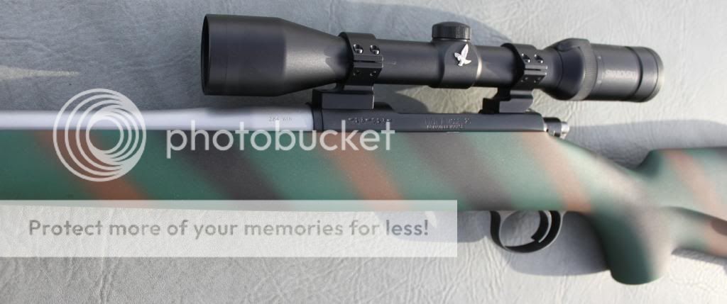

My particular model pictured is an AV which is the predecessor to the current Z3 and about 15+ years old yet still blows away the VX-3 optically. I covet this scope like a hobo does a ham sammitch because of the TDS reticle which,sadly, the current Z3 dropped as an option.
As for the customer service between the two companies...I'd call it dead even.
A couple of years back it took a huge hit on the ocular lens and bent it from a hard fall on some loose scree. The scope never lost zero but it was an ugly ding and concerned me enough to have it looked at. I called Swarovski and told them I needed warranty work but wasn't the original owner and had no receipt. They sent me a pre-paid Fed-Ex box and off it went to New York. It was back three weeks later still in time for hunting season with a brand new ocular bell,a full internal service and new springs free of charge! If that doesn't qualify as top-notch warranty and customer service I don't know what does.
Here's a photo of the same scope mounted on a Rem 700 S/A clone for size reference...
