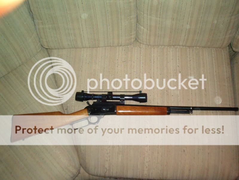

Marlin 218 Bee
Here's a pic of my new "varmint" rifle.:dancingbanana:
218 Bee
John Y Cannuck said:
Cool looking rfle. What's that awful looking thing bolted to the top of it? :eek:
It blocks the spot where a good peep sight would mount!
It didn't come with open sights. Anyone know where I can get some to fit this rifle?
Arch:)
Assuming that there's dove tails for and aft, SIR sells Marbles sights which are a great match for your rifle arch. Personally I'd probably go with a Lyman or Williams receiver peep site :cool: but keep the scope around for kicks too...
