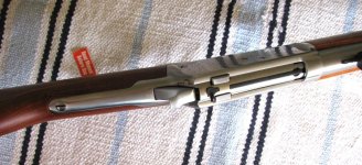

Got this Rossi M 92 lately, didn't fire it, but I am very impressed with the fit and finish.
44 Mag., 16"
