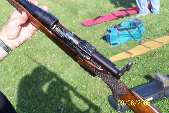

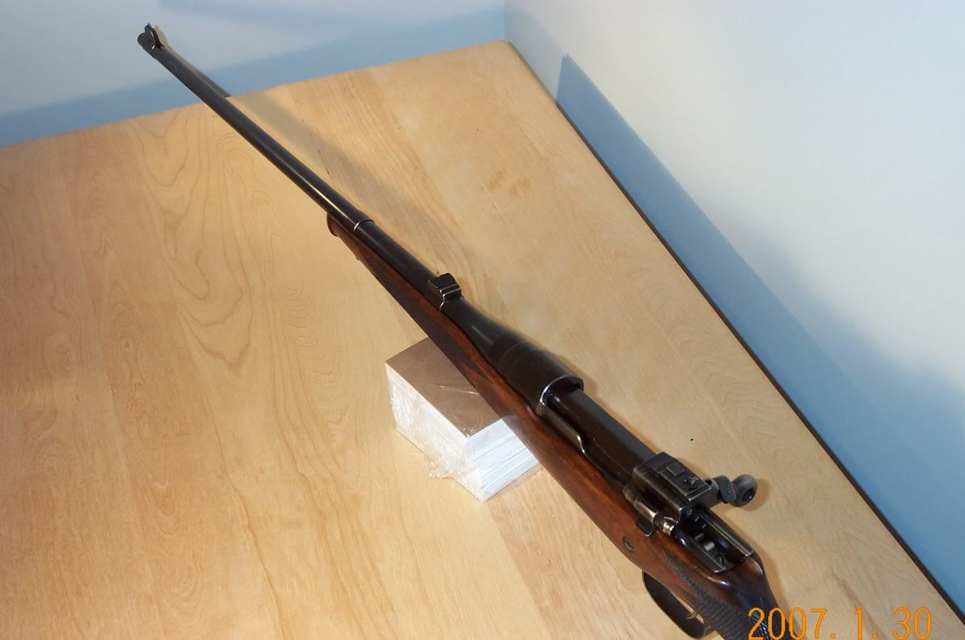

,280 Ross Model 10
Here is a couple of photo;s of a .280 Ross and there is a fellow on site has two boxes of 20 each of original cartridges not cheep
