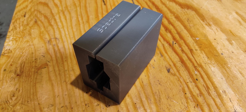

Hello CGN,
With production of our Light Practical Carbine coming along nicely we are now releasing the required upper receiver vise block.
Since the Light Practical Carbine is truly a novel firearm vise blocks for other guns like the AR15 are completely incompatible. We have designed a simple, easy to make vise block.
The Light Practical Carbine vise block is a 3d printed part that you can make yourself for free or buy from us. It is a single file that you need to print twice. It is released under the under the Creative Commons - Attribution - Non-Commercial - No Derivatives license. This means you can make your own for free, but you may not sell it, or redistribute derivatives of it.
You can access the files here: https://www.thingiverse.com/thing:4509500
If you don't have a 3d printer you can buy a set of vise jaws from us. They are $39.95.
---> Order Here <---
The following print settings should work for most printers:
  • Material: PETG
  • Layer Height: 0.3mm
  • Nozzle: 0.4mm
  • Infill: 60%
  • Infill Pattern: Grid
  • Skirt: Yes
  • Temp: 240
  • Bed Temp: 90
If you have a larger nozzle you can print thicker layers. We are going to try a 0.8mm nozzle and 0.6mm layer height.

Thanks for sharing the stl file.
I wonder if PLA would hold up with more infill?
I don't have a 3D printer but it's cool you are giving the file out for people that do. Classy.
I have soft plastic jaws for my vise, would they work as well? Maybe not as positive a clamp though.
Plastic vise soft jaws likely wouldn't work. You really want the vise block. We will have some available on our site shortly for those who can't print their own.
It probably would if you used a "tough" pla and printed it slowly. The issue with PLA is it can be brittle.
Yep familiar with the brittle issue with PLA. Will give it a try at 4mm nozzle, 2mm layer height, 40 mm/sec and 80% infill. Only 18 hours per side, lol
If that doesn't work I'll just get a spool pf PETG and hope it does not stink up the house.

Will there be one available for purchase with each receiver set?
Thanks again for the stl file SBI, that is awesome of you to release.

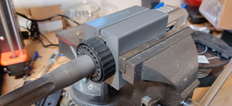

FYI I got some PETG and printed on my Mega-S using:
0.4 nozzle
0.2 layer height
Brim adhesion
60 Infill, Grid
240 nozzle temp
70 bed temp (I use white glue on my bed)
25 print speed
Fan cooling on at 50
The PETG is nice stuff to work with, thanks also for info on it.
I think I could crush this down pretty hard in a vice before it started to break.
I printed mine at 0.8mm nozzle at 0.6mm layer height and 30% infill. Only took 2 hours per side to print and it worked well. It did start creaking at 30 ft-lb on hte barrel nut. I think at 50% infill or higher it would be good. the 0.8 nozzle makes a very strong bond.
