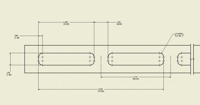

Is it advisable to attempt to lighten the barrel on my Ruger SR556, or would a new barrel need to be made, also can the handguard be cut along the sides for M Lock attachment points? I realize it might need to be re-anodized.
Any barrel can be re-profiled, however accuracy may degrade depending on how the barrel was made and the machining conditions. As for M-Lok, my guess would be a resounding No as, to my knowledge, the specifications are not allowed to be distributed outside the USA.
M-Lok doesn't look too hard:
I can't see how it would be proprietary, or restricted, given it's under a free license. I'm leaning toward re-profiling because the gas system is not a standard length, so adapting a DI barrel is out.
Unless they have changed their policy, the will not disseminate the information to Non-US citizens due to ITAR.
There's ITAR for holes in a piece of metal, that would be interesting to see enforced. Are all holes included, or just holes with names, or patterns of holes with names?
Incidentally, selling the product is disseminating the information, this is a very tough one to argue ITAR on, the item can be ITAR'd, I don't think a hole in a piece of metal can. Additionally the part that will receive the restricted technology, is already hosting an equivalent technology (a 1913 rail) and is an integral part of a restricted system, an AR 15 pattern rifle.

From magpul themselves:
3. ITAR Warning. Portions of the M-LOK System and TDP are considered defense articles and technical data that are subject to the
Arms Export Control Act (22 U.S.C. 7728) and the International Traffic in Arms Regulation (ITAR) (22 C.F.R. Parts 120-130). As part of
the express consideration provided for receipt of the M-LOK TDP, the undersigned acknowledges it is a U.S. Person and agrees that it will
not export, re-export or otherwise transfer, directly or indirectly, the technical data or defense article in violation of U.S. law, and shall be
responsible for obtaining any necessary U.S. government authorization from the U.S. State Department, Directorate of Defense Trade
Controls, as required to ensure compliance with all applicable laws.
Which is of course great if you're creating an M Lock product, and you require a copy of the TDP, if however you're just milling holes it's pretty meaningless. There's nothing being exported, reverse engineered maybe, but certainly never exported.
