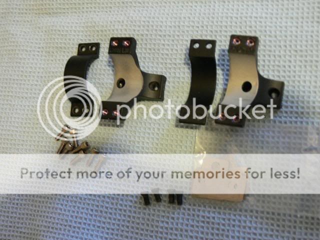

Talley one piece light weight rings/base, solid and very light (2.5 ounces)

I compared leupold 2 pc dual dove tail mounts to aluminum rail with clamp on rings and only 2 ounces difference. I went with them and would reccomend them over anything that clamps onto a rail. Solid steel but much smaller/stronger/compact, so the difference is not as much as you would think.
Best rings I have found go right on Rem 700 action no bases required 2oz made by RW Hart
I have the VX2 Ultralight, 3-9X33 on one of my mountain rifles. Most of my scopes are mounted in Talley, one piece, lightweights.
