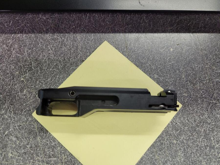

We did experiment with a lighter weight steel bolt, not aluminum like the Volq.
There are a few problems making bolts this light so we didn't make them. The main issues were that everyone wanted these to shoot CCI Quiets. With only 710 fps of energy there just wasn't enough power to reliably cycle the rifle even when it was clean, polished and had a lighter recoil spring. I could get our testing rifle to cycle the Quiets with about 85% of the time only. That, unfortunately, isn't good enough to sell as a commercial product.

You wouldn't like the price. I spent a half hour machining it and chewed up a carbide end mill. Oh, and it's Nitride finished ,lol. Yup, I have a porblem if you haven't noticed / :

No, it took a half hour to MODIFY an existing bolt. You want it ? Yours for only $300, private sale.
