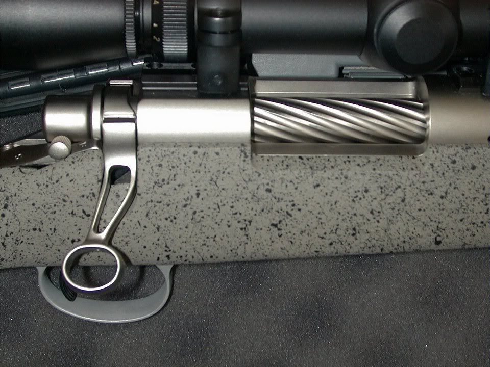

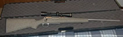

Here is my Mtn Rifle:
Rem 700 SA w/turned down shroud, fluted bolt, skeletonized handle, trued and then Elecroless Nickel Plated (stuff is bombproof).
22" Gaillard 1:9 Stainless .550" muzzle (Rem Mtn contour)
Wildcat Model 7 Stock inletted for a rem 700
Leupold 2-7x33 VXII
Now wears Talley LW rings (pictured w/Burris Zee Rings)
Pushes a 140gr pill @ 3000fps (3030fps w/140 Accubonds and NP's, a few fps less with 140 BT's). It groups the AB's better than the pictured group, and NP's consistently into 1/2"... usually less.
[Leupold 2-7x33 VXII
It weighs 6lbs 0 oz all up w/ Butler Creek flip caps
