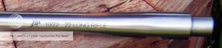

I had a sporter contour one on my 10/22, it shot very well looked great, but to be honest I expected greater accuracy then what it produced.
