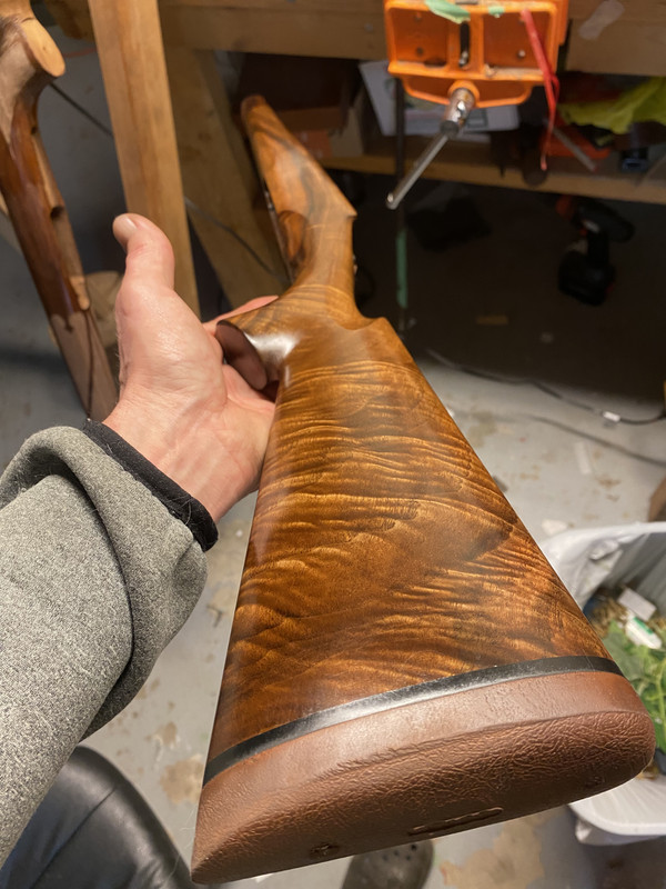

-Stripped furniture with Klean Strip
Let dry over night
-Espresso Stain let stand for 20-30 mins. wipe off.
Let dry for 24 hrs.
- Seal with multi coats of Minwax Antique Oil.
That looks fantastic.
