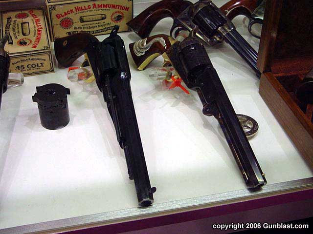

Or you could just wait and get the new 1858 conversion that Cimarron is supposedly coming out with:
