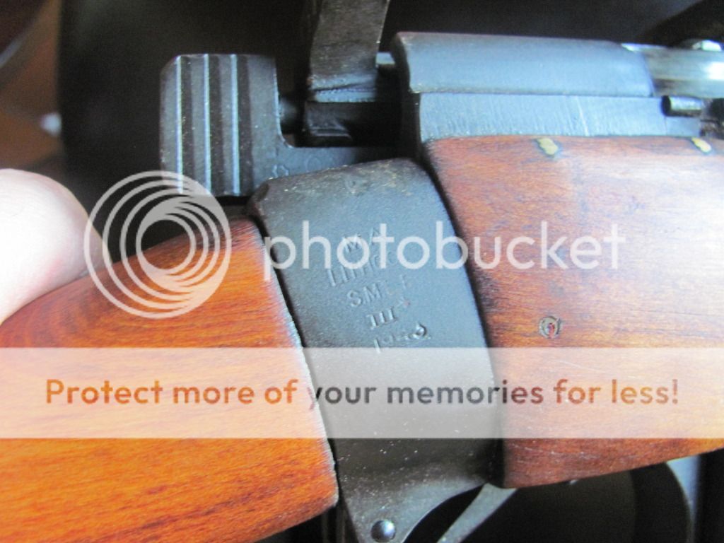

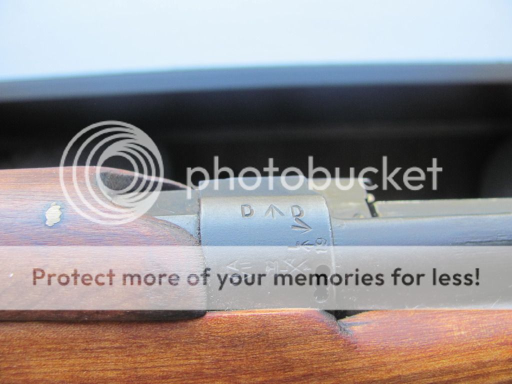

At first glance, the nosepiece, receiver, and bolt match. But it's a bit of a frankenrifle. The wrist is dated 1943 I think...but on the other parts of the rifle, the finish and stamps are in better shape.

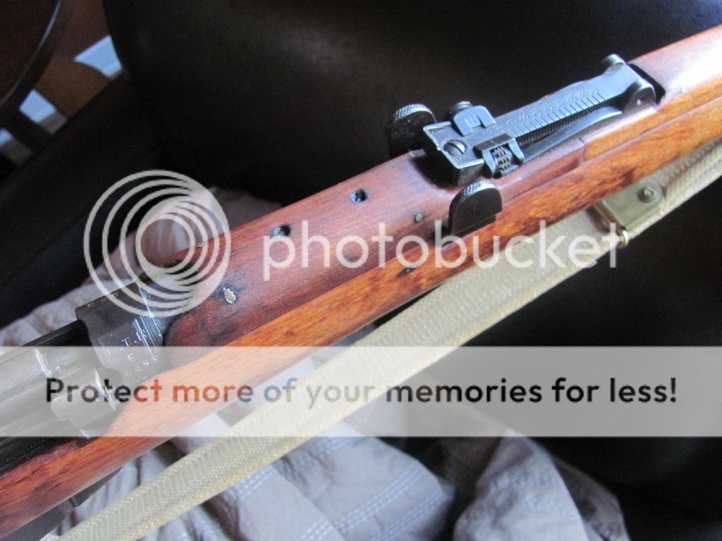

I see it has been FTR'd at some point. Also the rear upper handguard looks homemade. Will be looking to replace that I think. The bore is good with good rifling. The rest of the wood is pretty, but shows signs of sanding, albeit lightly and almost totally concealed.

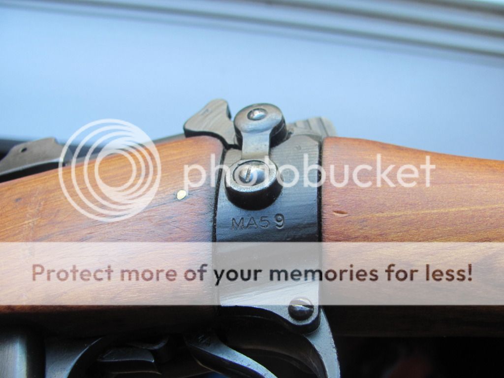

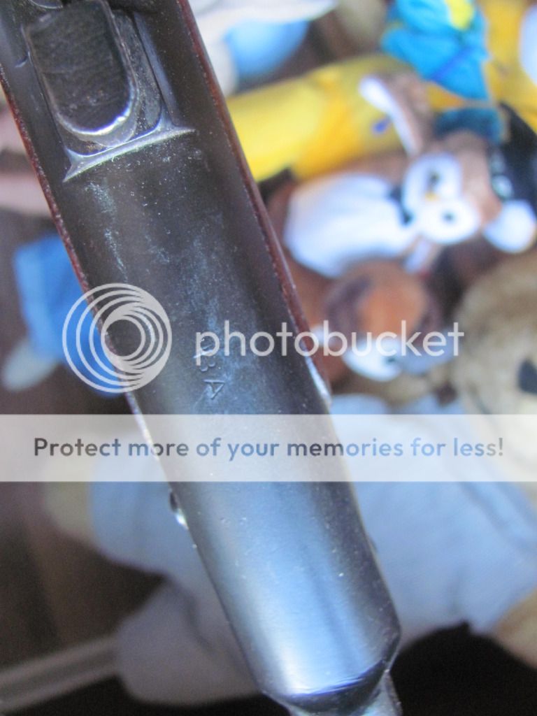

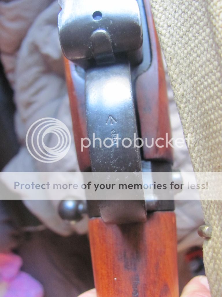

What does the MAS 59 stamp and the BA under the nosepiece mean?

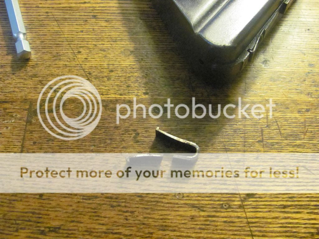

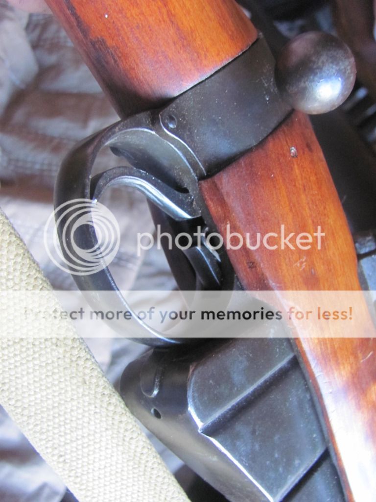

The rifle will not #### and the trigger is just freely swinging. When I get some time I'll disassemble and look to see what's broke.
This is the homebrew handguard. It's not half bad other than the sanding marks and it's still a little too wide.
The Trigger has no tension.

It's a 1943 rifle FTR'd in 1959.
If no pressure on the Trigger, then either it is assembled incorrectly or (less likely) you are lacking a Sear Spring.
Number 4 Sear Spring works, BTW. This is good for me as I have a binfull of them and lack Number 1 parts by the bushel!
How do you get the idea that the rear upper guard is "homemade"? Those brass pins are actually screwed rod, correctly factory inserted to prevent breakage of the part. There was lots of oversize wood made, some of the Indian stuff being almost ridiculous, but there also was o/s Aussie wood. This has just been sanded for a better fit onto an existing wood set.
Australian practice normally was to mark the history of the rifle onto the right side of the Butt. My 1918 has its original 1918 markings, plus rebuild markings from 1931 and 1944. Yours is marked on the Body (MA 59) but you show no Butt markings, so I am assuming a new Butt in 1959.
Make sense?
I'm no expert but I believe the "Mas" is actually "MA 59". I looked online and MA is a lithgow new south wales Australia manufacture stamp. The wood is very nicely colored, looks just like the wood on my 1916 Australian no1 mk3. When you pull it apart you may find that the sear in the trigger group is either broken or missing. Nice pick up!

I just thought that the piece was so oversize and with the rough sanding marks still visible it wasn't likely to be done by an armoury. Thanks for the corrections and yes, what you say makes sense.

After some sage advice from a good nutter I pulled the trigger guard off and this fell out. Busted...
No biggie, I got friends with parts. ;)

Got a spring from a pal last night at my rifle club. Stuck it in tonight and she's almost ready for the range.

the rear top handguard in my opinion does NOT look homemade, ive seen many out there that look like that, you have to remember the British Empire produced the No1 mk3 for +30 years, so many parts varied.
Based on the opinions of some good nutters, I am also convinced that the handguard was armourer installed and am not thinking of replacing it anymore.
