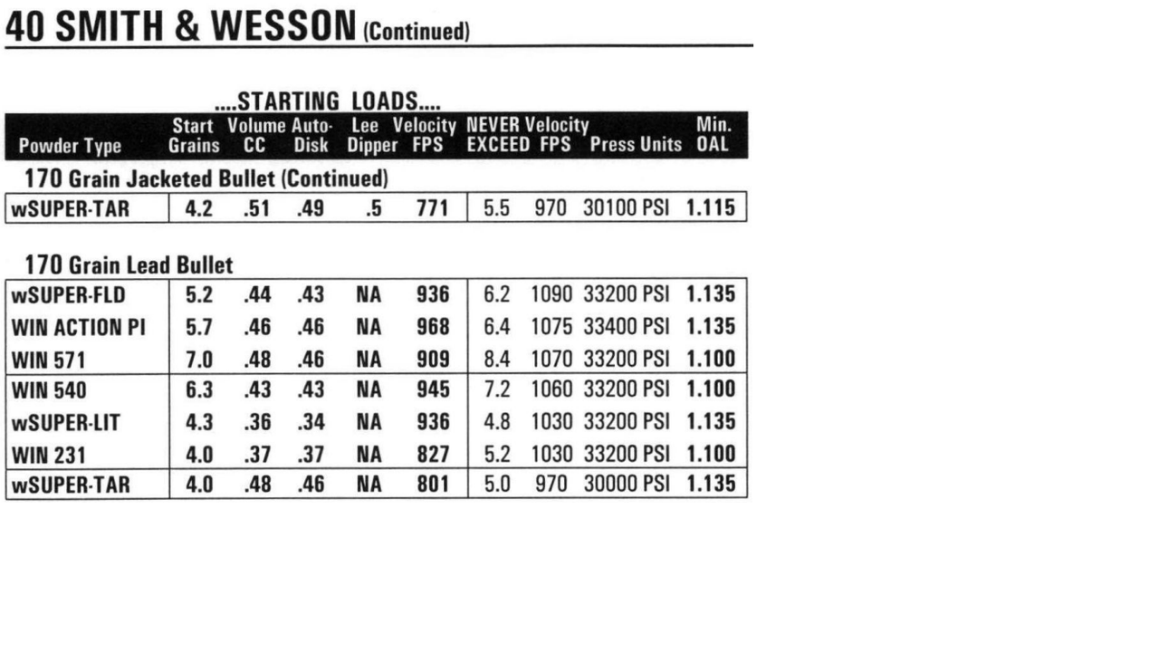

As for data, I was able to find 231 under a 170gr lead bullet which should be close enough to start at min and work your way up.
When it comes to OAL, ALWAYS determine your own with the barrel/bullet combo you intend to use, never copy the OAL published in data/manuals. So, for you, that's 1.13 or shorter, as you've already determined that in your barrel that length will both plunk and spin freely. Every barrel/bullet combo is different. Example: My Glock or M&P in 9mm will accept an OAL of say 1.14 with my preferred 147gr bullet, but my CZ Shadow, with the same bullet, won't plunk until I get it down around 1.08ish. So for me, in 9mm, I load my 147gr bullet at 1.08ish so that my ammo works in everything, because my CZ requires the shortest OAL of all the 9mm guns in my safe. Although you should be fine, the magazine will also sometimes determine how long the round can be loaded.
