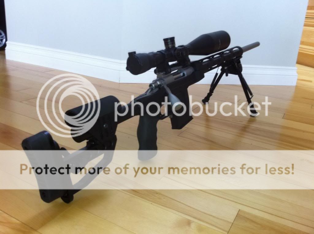

I finally got a chance to shoot my new rifle I pieced together over the last few months, show and tell time.
Specs;
-Rem 700 5r action and barrel .308
-XLR chassis
-Timney
-Sightron 8-32x56 LRMOA
-NF rings
-ATRS rail
-Recessed crown and knob done by ATRS
-USO anti cant
-Harris
Took it out this morning to burn some powder;
-178 AMAX
-41.5 - 43.5 varget (.5 increments)
-CCI BR4
-New lapua brass
-COAL 2.810
Did 5 shots at 100yd and 5 at 300yd. I`m happy.
41.5 and 42gr look promising, 41.5 measured out to 1.877" and 42 to 1.914" at 300yd. I don't have a chrony to verify velocity maybe someone with quickload could ballpark me? I was hoping to be around 26-2650 but I don't think Im there at 42gr varget. I think I might load by .2 from 41.6 to 42.4 and see what happens. Any advice is appreciated.

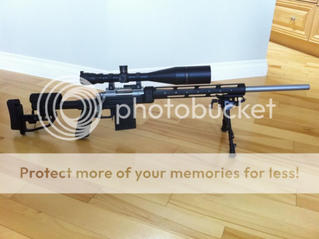

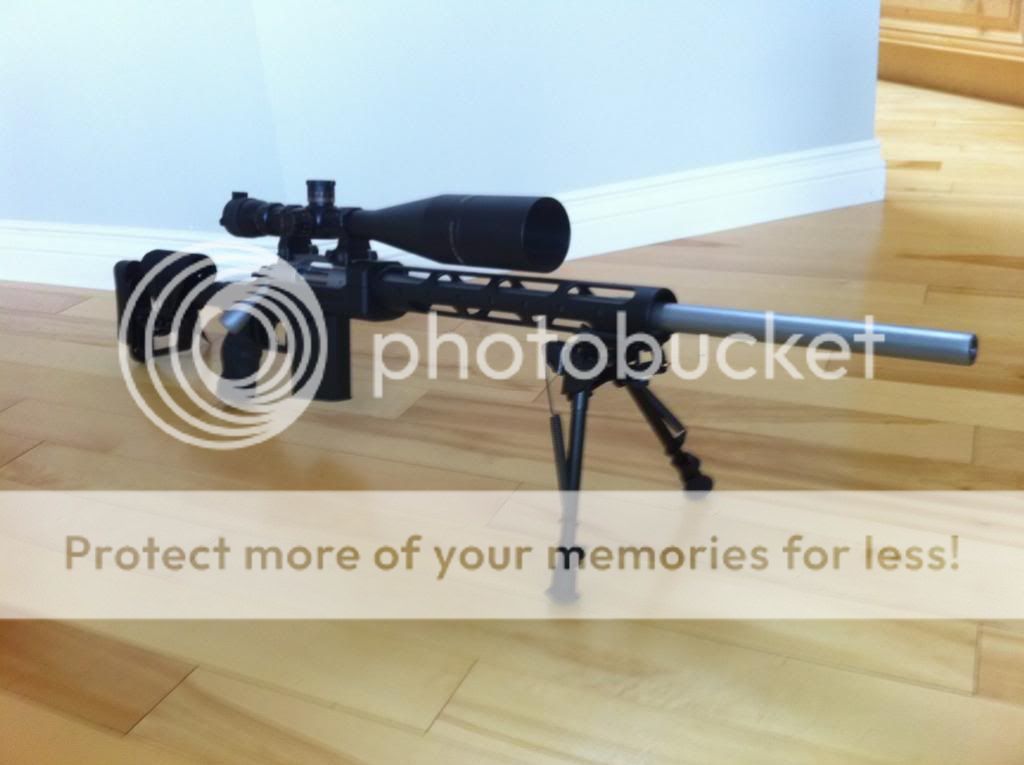

Some crappy cell phone pics of her
It was the first time I've had the pleasure of touching a nice trigger, if anyone is considering it... do it. Its awesome. I've been using the original Remington factory trigger on my other bolt gun and its good but has NOTHING on the Timney. The chassis is very different than the HS stock on my 223 but it feels good, I really like the adjustability, its built very very well but most importantly it looks badass. The total package weighs in at 14.2lbs.
Thanks to all the CGNers and site sponsors who helped me to get this bad boy together.
