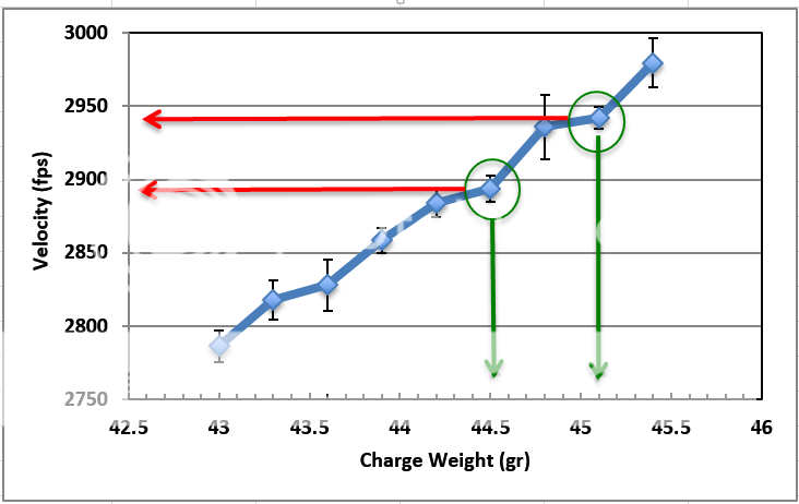

My process has always been identifying the min and max load. I don't bother with minimum charges as I want some good velocity and accuracy.
I start somewhere near 30% over minimum. Then in something the size of a 260 case, work up in 0.3gr increments. Usually I end up with about 6-8 charges to test. I load up three of each charge.
Then I shoot 3 shot groups and measure velocity. Ideally i'm looking for something that groups well (200+ yards) and has good ES and SD. Then I will go a step further and plot all of my results using the averages and error bars representing the ES. I look for the flat spots in my plot that indicate velocity in-sensitivities to charge weights (or pressure) and low ES's. That way any small errors in reloading practices are not so detrimental to POI. If I see pressure signs I stop, brass life is also a consideration.
This is the latest load development I did. You can spend hours upon hours tweaking loads, or you can settle on something reliable and acceptable and go practice more; I always lean towards the latter.
