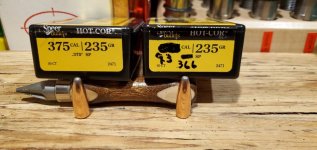

The Speer 235 grain is relatively cost effective, it’s close to the only one these days. 35 bucks for 50 and they are a lot better than people who haven’t used them would think. I should put in the disclaimer that I haven’t used them in the ‘bee, just the H&H.
Cast bullets are a different thing; there’s not much thats more fun than a bigger rifle and an ice cream pail of cheap ammo :)

I’ll have to see if the local shops have any 235’s, that sounds like a fine idea. For medium game around here, they oughta be fine anyway.
I have some 250gr Sierra SPBT GameKings, but found that even at 2850fps+ MV they don’t expand on deer size game.

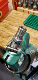

Interesting, that makes a lot of sense though. What did you use to under-size your cases?
Being a sort of reloading geek I used to reload for 32 different calibers) I have a large assortment of dies for other calibers that were "close" to the dimensions I needed, sometimes i have to use an assortment to achieve what I want....and I have a lathe to make case mouth expanders to my spec or modify an old die to what I need.
You might throw your hands up and say "I dont have all that sh!t but have faith...gunshows have a lot of tables that offer old dies and part set very inexpensively
