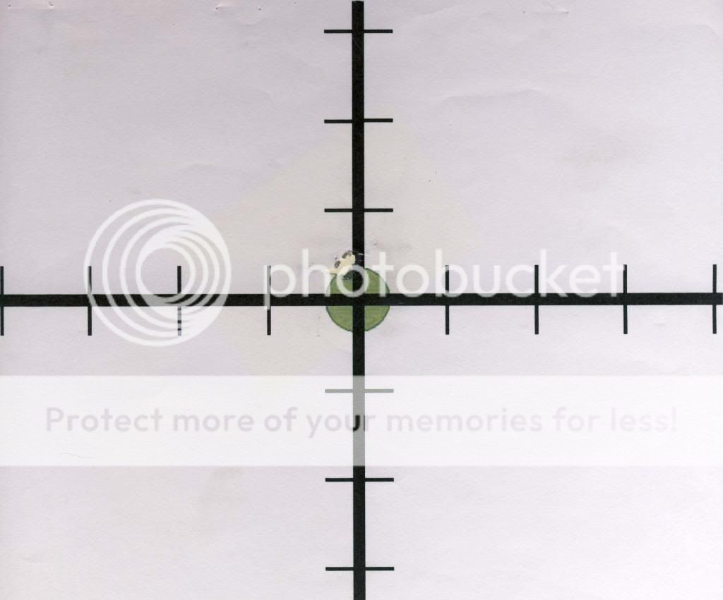

Action is a Stiller Tac 30
Manners T4 stock with a pound of lead in butt.
AICS Bottom metal
Nightforce 5.5-22 Varminter in Seekins Rings and 20moa Rail
Bartlein Barrel 1/8 Twist at 28"
Shooting off the hood of my 89 GMC 4x4 with an Atlas bipod and sand bags for a rear at 100 meters.
Smithed by Craige Douglas
Started load development last summer but ran out of time to shoot before my second son was born. I wanted to try some H4350 with some Berger 105 Hybrids, I was using old 95gr Berger VLDs initially.
After I finally got my hands on some powder I reviewed what poor shooting notes I had made and I shot some groups that looked like they had some potential. I have been getting up early in the morning before work to try and get some calmer conditions with little mirage. I had another look at my notes and switched back to VV-160. Went out tonight and shot the following three shot group.
41grs VV-160 Berger 105 Hybrid, 205M Primer. .269 Bushing with a reamer for no turn .274 neck. COAL is 2.700 give or take a couple of thou.
Next step is to hopefully get some time to shoot more groups over the chronograph and see what the SD and ES is. Maybe try some of the RL-17 I have and try and make the H4350 work as well.
