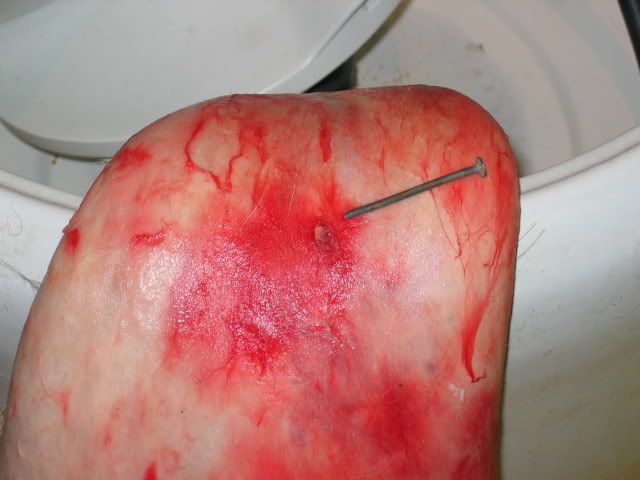

35 gr Bergers are Gods gift to fur hunters. This picture is of the neck of a male I shot at about 125 yds. No exit and 2 little stitches. I also didn't have them screaming out of the barrel either ,somewhere around 3700 fps.

from what Ive read (researched the 204 a bit this winter), the 35 Berger is the fur bullet of choice. Hornady just came out wit a 45 gr. soft point too, so Im sure that is marketed towards predator hunters.
