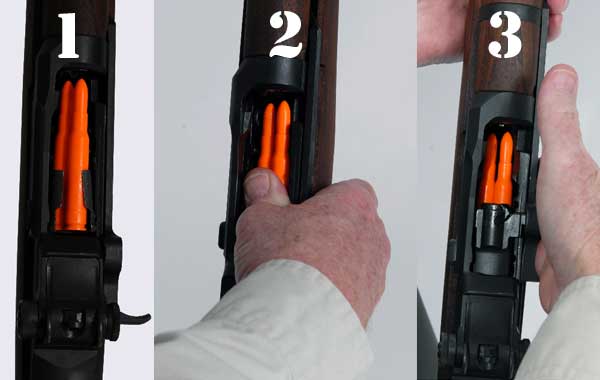

"...pushing down the clip releases the action..." That's what it's supposed to do. Note where the guy in the picture and video have their hands. Clip in rifle, thumb on top with the rest of your hand outside the action in front of the op handle. Push down. The action should close, then give the op handle a thump to finish closing.
