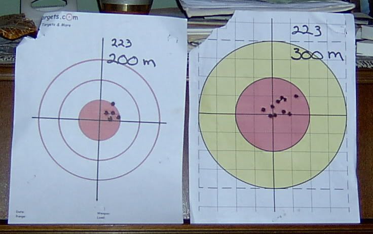

My BTVSS in 223 like 69 sierra matchkings. CCI BR primers and 25.8 gr of Varget. Pics of last weeks targets.
