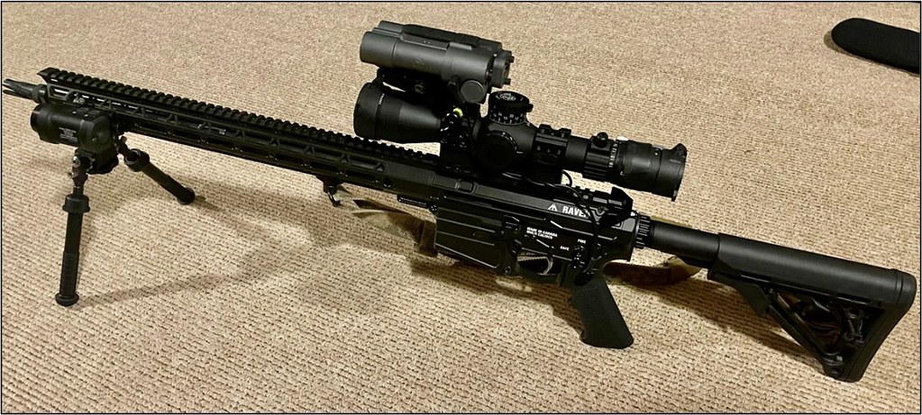

To reduce variables, testing was done with a quality flash suppressor and bipod and a proven scope with a history of high precision and accuracy on another precision rifle.
Scope; Leupold Mk5 HD 3.6-18 x 44 with a Tremor 3 reticle with a Silencerco Radius laser range finder.
Flash suppressor; Infinite Products Solutions 3 prong.
Bipod; Atlas BT10.
Trigger; Bravo Company PNT Trigger Assembly.
Stock; Magpul CTR
Magazines; Magpul 5/30, assorted metal 10 rd pistol mags.

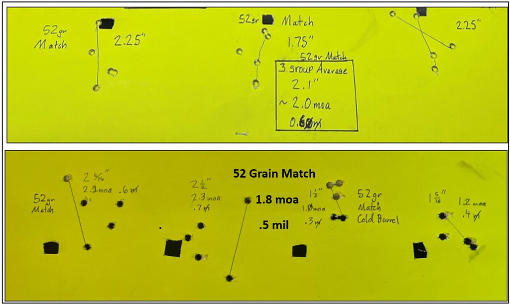

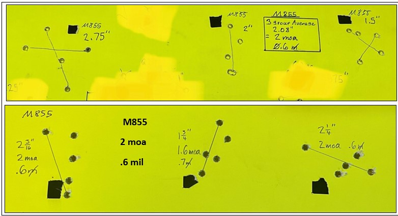

Nine 5 shot groups, 3 groups each of 62 grain M855, 52 grain Match and 62 grain Match were fired at a slow rate from the prone position with a firm rear bag and a bipod at 1 cm squares at exactly 100 meters.

Eleven 5 shot groups were shot, 3 of 62 grain M855, 4 of 52 grain Match, and 4 of 62 grain Match, at a slow rate, from the prone position with a firm rear bag and a bipod at 1 cm squares at exactly 104 meters.
Temperature was +2c and visibility was clear and sunny. Position was broken between each 5 round group. Each string was fired in approximately 3 minutes.
The rifle was allowed to cool at least 30 minutes between each string. However, on the last string, 52 grain Match, the final two groups were each fired after allowing the barrel approximately 1 hour to return to ambient (+2c) temperature.

62 gr M855 : 2 moa / 0.6 mil 0.4 moa Standard Deviation (SD)

52 gr Match : 1.8 moa / 0.5 mil 0.5 moa SD

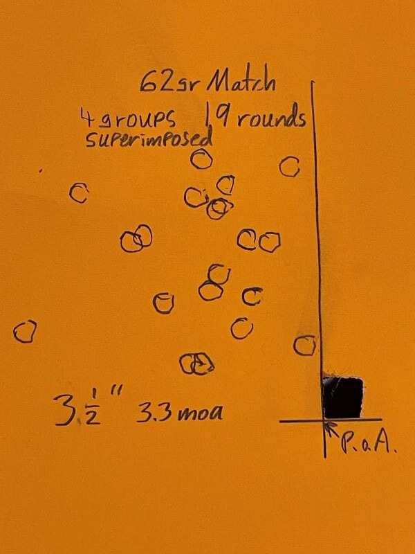

Cumulative group sizes (all rounds of each type superimposed onto one group.)
62 gr M855 : 2.3 moa / 0.7 mil
62 gr Match : 3.3 moa / 1 mil
52 gr Match : 3.3 moa / 1 mil

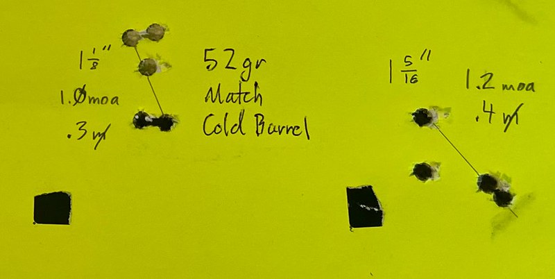

Average of 2 groups when barrel allowed to cool to ambient temperature.
52 grain Match : 1.1 moa / .3 mil

It is expected that a medium profile barrel would enhance precision while maintaining an acceptable weight and balance.

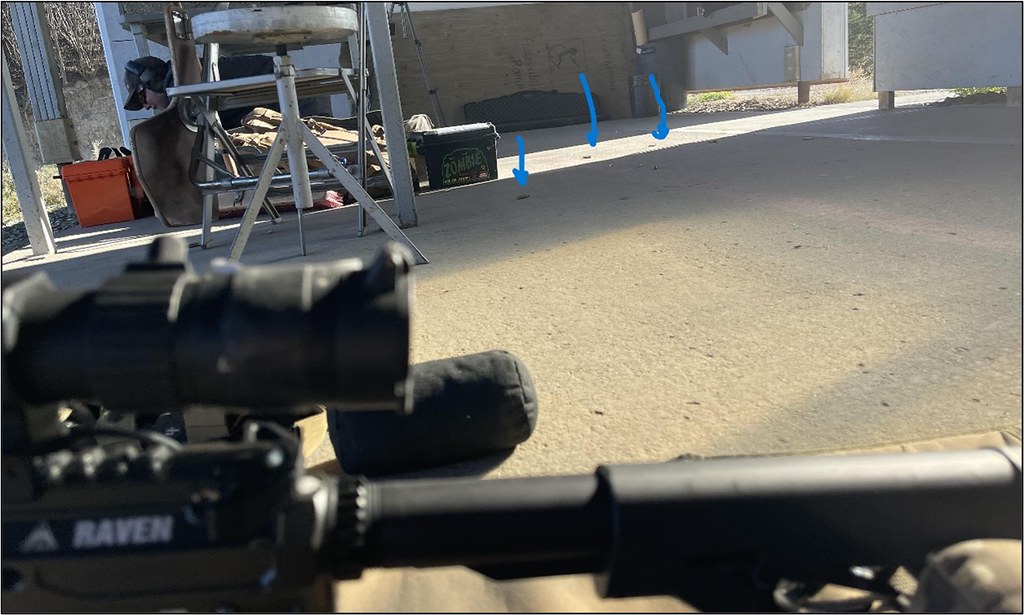

It cycles flawlessly even with poor quality ammo, positively ejecting brass to the 3 to 4 o’clock at 2 to 3 meters.

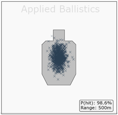

With 62 grain standard ball and match ammunition it is capable of high probability hits on IPSC sized targets out to 500m.
(Credit; Applied Ballistics Analytics)
