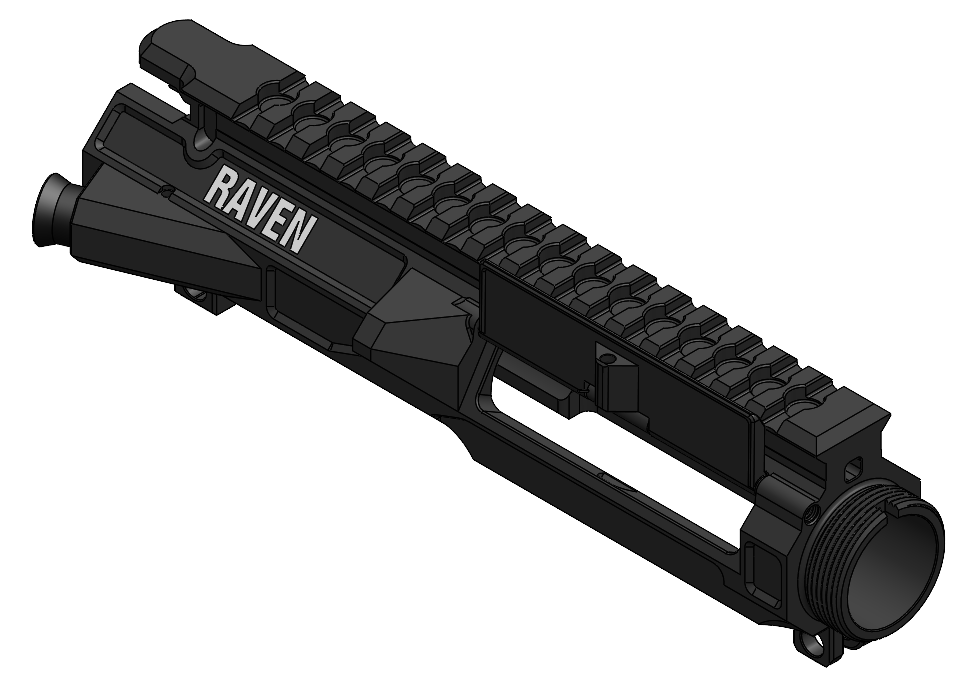

The Raven features several unique aspects that other Modern Sporting Rifles do not, including a scalable Lower Receiver with a removable Magazine Well. The removable Mag Well facilitates the use of different calibres in the Raven. You simply install the Mag Well of your calibre choosing onto the remainder of the Lower Receiver. You then bolt on the caliber-appropriate Upper Receiver and away you go! Multiple calibre options are planned to take advantage of both intermediate rifle chamberings as well as common pistol loads. Another unique aspect of the Raven is its multiple configurations and options for charging the firearm. There is Left-side charging, Right-side charging, and the conventional AR15-style top-charging handle to select from! Controls on the Platinum edition are fully ambidextrous, but are not necessarily interchangeable with standard AR15 controls due to the different contours of the Raven's Receiver set.
The "Platinum" edition of the Raven ships with a hybrid Handguard consisting of a Picatinny rail on top and MLOC slots at the 3, 6 and 9 o'clock positions. It is retained by a push-pin the same as those used to join the Upper and Lower Receivers, the Mag Well and the remainder of the Lower Receiver. The top Picatinny Rail is continuous between the Receiver and Handguard, although there is some minor rotational play in the Handguard that could affect lasers or other precision instruments. This play can be eliminated through the use of a standard AR5 Handguard which clamps to the Barrel Nut, rather than being retained by a push-pin. Note that the push-pins used to assemble and take-down the Raven are not captured and should be carefully retained in a zippered pocket when in the field.
The Gen 2 Bolt Carrier is much beefier than the breakage-prone Gen 1 Carrier. Like the Upper and Lower Receivers, the Bolt Carrier is proprietary, being longer than the standard Carrier employed in an AR15. The complete Bolt, Firing Pin, Cam Pin, etc, are compatible with the AR15 for ease of repair with readily available spare parts. As always, the Trigger-Tech 3.5lb "AR Trigger" is a very worthwhile upgrade, serving as it does to enhance the rifle's accuracy moreso than just about any other components.
