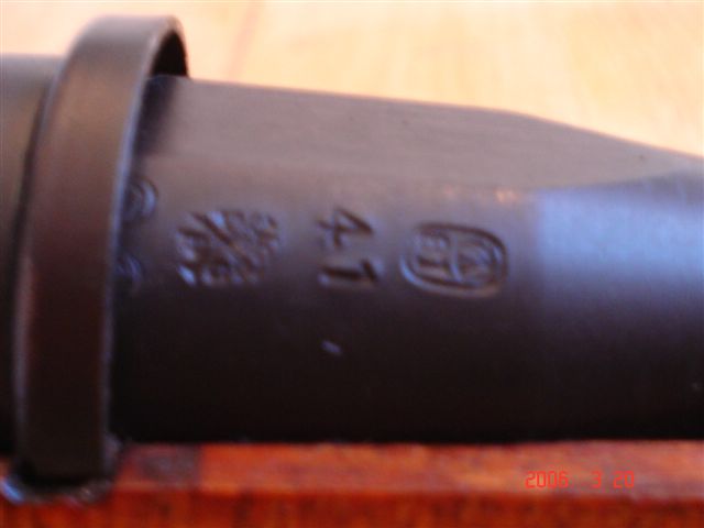

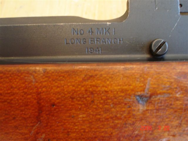

Regarding serial numbers on barrels, my 1941(first year production) has matching number and year on barrel, as were both 1942's I owned. The few 1943's Ive owned did not, so maybe practice was dropped by this point. Same applies to the 1944 and 45's that have passed through my hands.
As for rarity? 1941 (holy grail), 1945,1942,1944, then1943(most common) IMHO. I'm talking war years here obviously. The production run of 1949 and 50 was small but most survived service, probably the best finished LB's also.
Glad I bought my LB's when I did, but you'll find a deal if patient.
+1 ......... :)
Pics... Pics ... Pics .... Pics ....
Please Sir ............. :D
Regards,
Badger

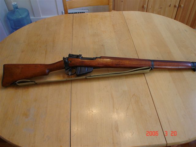

1941 Lb
Ok Badger, will email some to you later today(its 04:25am here on the west coast..cant sleep) Feel free to post them if you like, I havent had the chance to figure how to do it yet.
Geoff in Victoria
Agree with Geoff :) Not all LB's (or even all No.4's) have seriallized barrels. Also, alot of mags are not serialized and never were.
Also common to find alot of Savage parts on LB's after mid-1944. When Savage stopped production, all the spares were sent to Longbranch and used up in production there. Many '44 and onward LB's will, for example, have unseriallized Savage magazines, sometimes milled Savage trigger guards, the odd piece of savage-looking birch stock wood with C-broad arrows stampd into it, etc.
