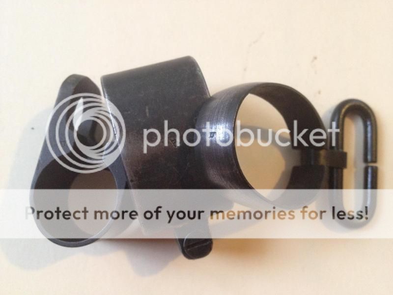

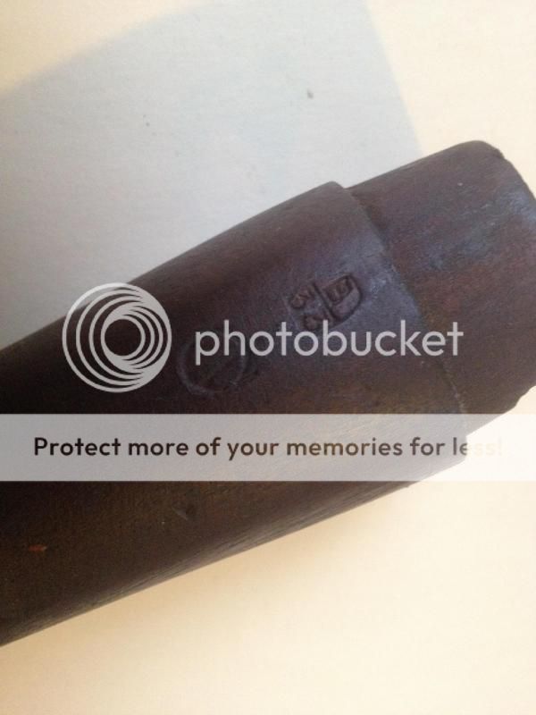

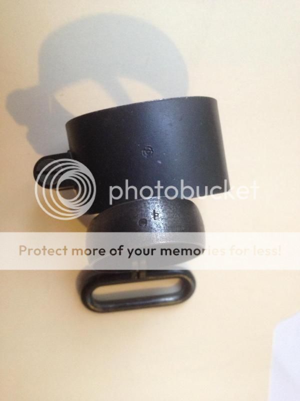

Have a look on some spare parts I have, there is the LB mark everywhere...
Now, I only need to find a nice sporter marked LONG BRANCH! Two must be better...
