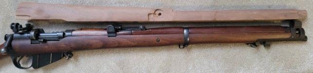

Here's a Long Lee forestock from Prestigious atop my BSA SMLE. A little short so some surgery and grafting would be required.
