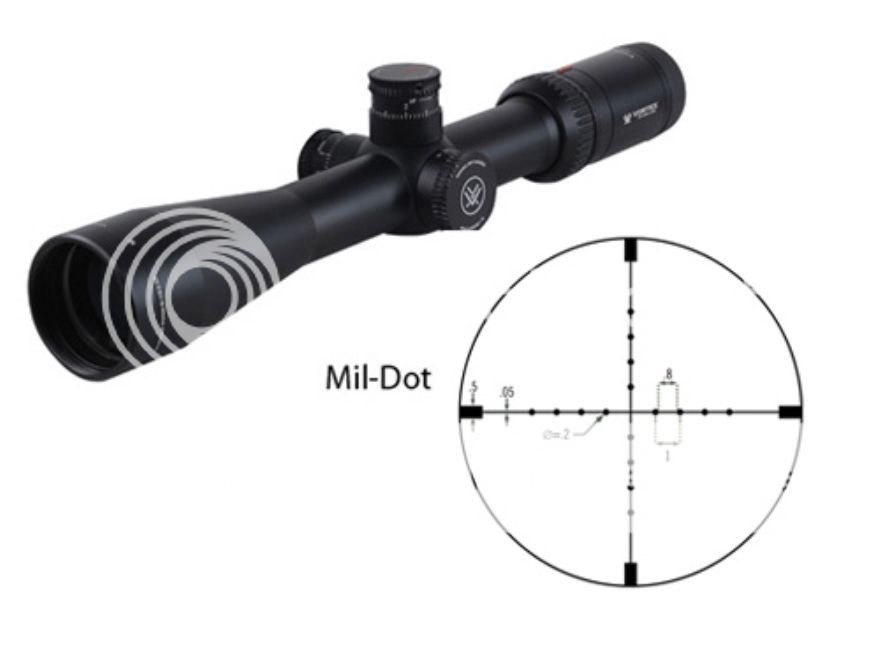

Vortex Viper HS Tactical Rifle Scope 30mm Tube 5-15x 44mm Side Focus 1/10 MIL Adjustments Mil-Dot Reticle Matte. A midway exclusive at $499. Gets great reviews, but you would have to do the import paperwork.
