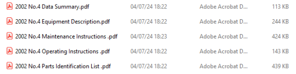

I've got the following DND docs from 2002
C-71-111-000/MA-000
Slug870 send me a PM with your email and I'll send them to you
