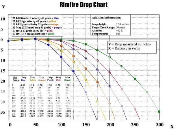

You might want to have a look at the wind drift chart posted above.;)
I keep seeing reference to the wind drift table, but I think the temptation is to look at the 250 yard mark and say "SEE??? SEE??? The 22WMR drifts about 13"-14" MORE than the HMR!!!" Hanging your hat on that data suggests that #1. the HMR is still drifting so little that you'll be able to HIT your targets with an HMR while your .22WMR shooting buddy won't, and #2. the wide spread between them, at the far end, is a practical range to be shooting these calibers.
Neither is true in my opinion, and neither speak to the drop factor either. (one of the other 2 charts posted)
If you're attempting to reach out to the outer limits of what's indicated on that wind drift chart, you're rolling the dice. Neither bullet will have much gas in the tank, and both will be heavily influenced by wind/wind gusts/drop etc. They're impractical ranges for magnum rimfires, in my experience.
