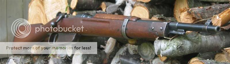

Mine is only a few hundred serial numbers removed from Oswalds. I've got the correct folding bayonet as well, but don't have pictures of it installed.
They've got a bad reputation, perpetuated by the same line of thinking that considers anything French or Italian substandard. The cartridge was way ahead of its time (as far as when it was issued) but they handle like a dream, and I just love mine.
